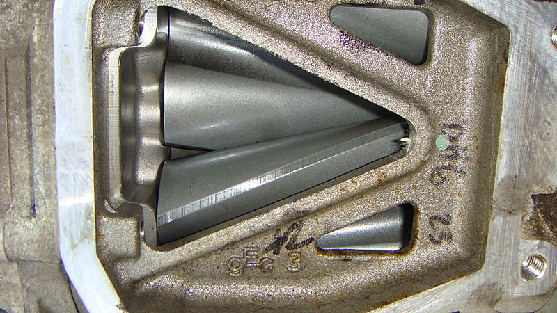

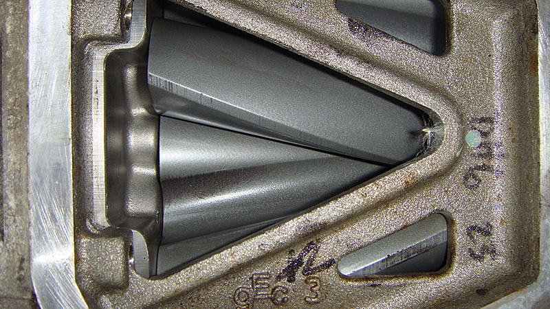

Over the weekend I was driving my car and noticed a complete loss of power. The car still ran but didn't have any go, also there wasn't that familiar whine or the air sucking noise from the intake. I assumed it was the supercharger and after reading all the info on the boards I went ahead and removed it from my car. Attached are pictures, should the vanes be all black? It seems they have some sort of coating on them, but its definitely not black. I did crack open the pto gear case, there was oil and the gears appear in perfect condition. I also took out the oil plug on the SC and there was oil in there as well.
I guess my questions are, base on the pictures, does it seem my SC is indeed worn out? Should I still do a PTO gear rebuild even though everything seems fine in there? Should I change the water pump while i have everything torn apart?
FYI: 2003, ~65k, M7 pulley put on at ~53k
Thanks in advance...
Attached Thumbnails Supercharger help-dsc02098.jpg   Supercharger help-dsc02102.jpg

I don't see any flakes of coating coming off of the vanes, they really don't look that bad. If the gears are fine also, I'd say the supercharger isn't your problem. I'd refresh the oil in both ends, not much need for a PTO rebuild if things are still OK. Everything spins smoothly and freely by hand, right?
Have you looked at your bypass valve?
Jason

So they are not supposed to be black?
Yes everything turns just fine.

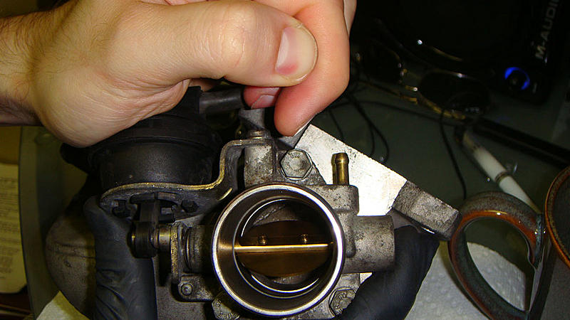

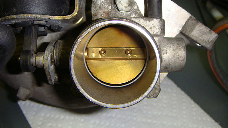

Here are the photos of the valve. I'm not sure but i dont think its bad. It was (90%) in closed position when i took it off. If I remove the hose, push in the vacuum dealy so that the butterfly is 100% open and put my thumb on the hose the butterfly will close to about 75% and stay there. Is that normal or should that be at 100%?
If its not the valve do you have any other ideas?
Thanks for all the help guys.

It really needs to close 100% to make any power. The fact that it was like that when you took it off suggests it is bad

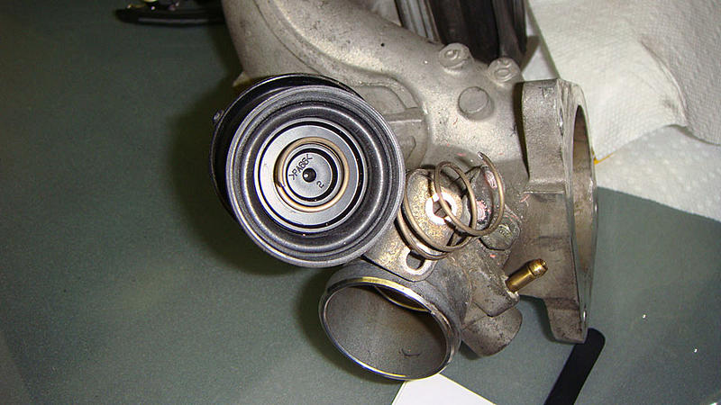

it's cooked...
off the car, it should be closed all the way. Vacuum opens it. If you're curious, get about 3-4 jewelers screwdrivers and take the diaphram apart. It's not too hard, but be careful as the plastic likes to crack.... I think you'll find a broken spring like in Keith's photo...

Good call! Broken spring indeed. I'm very happy to know what the problem is, and have already ordered a Detroit tuned valve. Again thanks all around.
