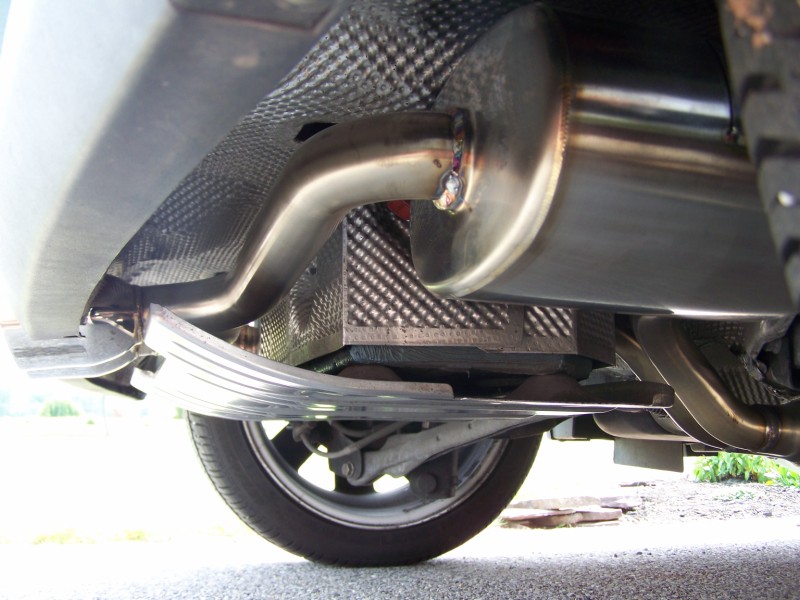

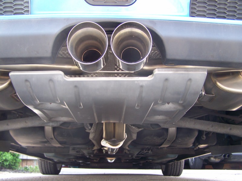

Installed mine Saturday!! As stated above, its a beautiful system, welds are great. When I first fired it up it was so quiet, but slowly getting louder I did tweak the hangers with some washers to get the tips from hitting the bumper. My only querk is that the passenger side tip looks crooked I'll post pics later.

2. Installation: Pretty easy. Recommend a hoist. Alignment of the tips was off-center and too close to the bumper. Used washers on all the hanger-bolts to lower the tips away from the bumper. Needed to lower thet tips approximately 1.5cm to get stock-like clearance. Alignment still an issue. Will have to bend the hangers that came welded to the mufflers. Approx 1 cm off-center as is. Tips do not protrude any more than stock. Slightly less than stock if any different at all.

Holding up very nicely. No problems of any kind to report. As mentioned in the original post, I intended on bending the hangers to fix an alignment issue with the tips. Did that without fanfare and the alignment is spot on.
