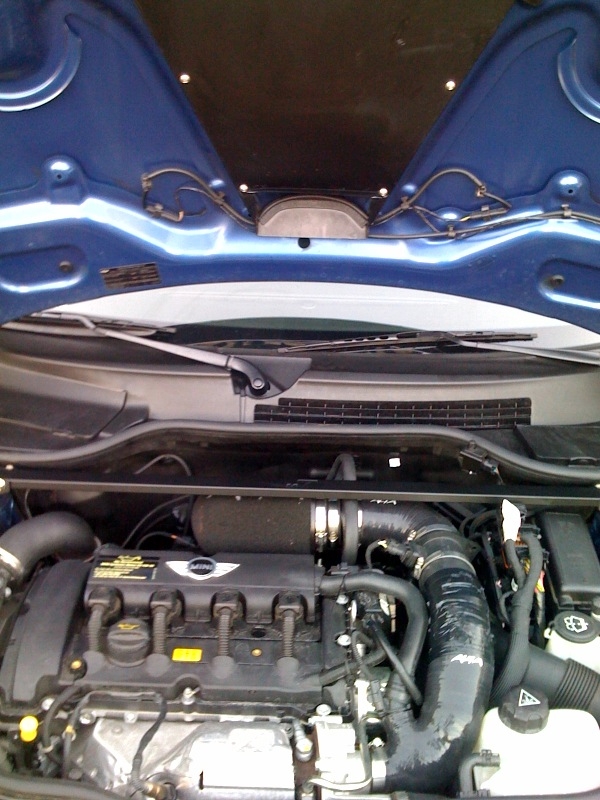

I think the DDM with the later option of adding the RIS is a good choice. The Alta is a nice product but the DDM uses the bottom of the stock air box. The filter is right on top of the stock air supply. Now the alta also uses the stock air supply. But the Alta has it just piping under their air filter. So some goes here some goes there... The DDM the filter is placed blocking the stock air supply so you will get more of the cool air from the stock air supply with the DDM. You can use the RIS system with the Alta if you choose but it wont work as well as using it with the DDm. Now if you have a strut bar, I dont think the DDM will fit. And the strut bar is VERY important on these cars. Here is a under hood shot of my old setup. Alta HFI (High Flow Intake), DDM RIS, M7 strut bar, ALTA PNP Unichip all working together under the same hood. I since have changed to a different setup.
Attachment 41576
So your saying the m7 strut bar works with the ram air scoop? No rattles, knocks, noises at all?

I the M7 strut bar in the back position (closest to the cab). and it did not touch at all, no rattles or anything. However I don't know about if you put the bar in the forward position? and the DDM Race (pressurized filter box) will not work with the strut bar, or any strut bar at all. Thats what DDM told me. The street intake may work I never tried it.
