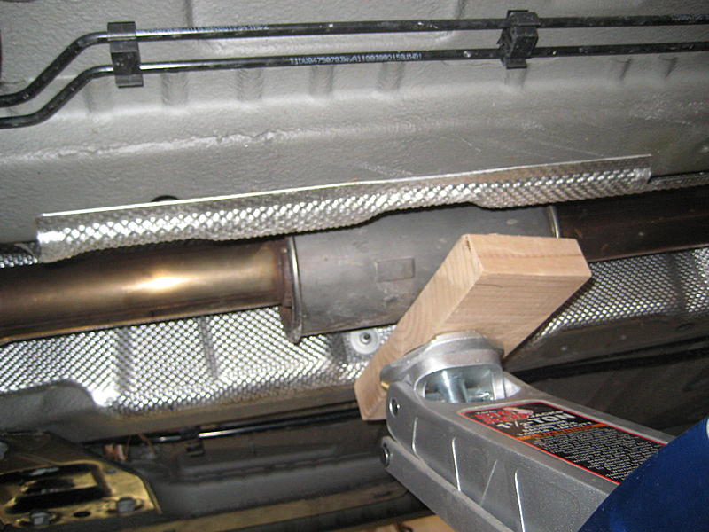

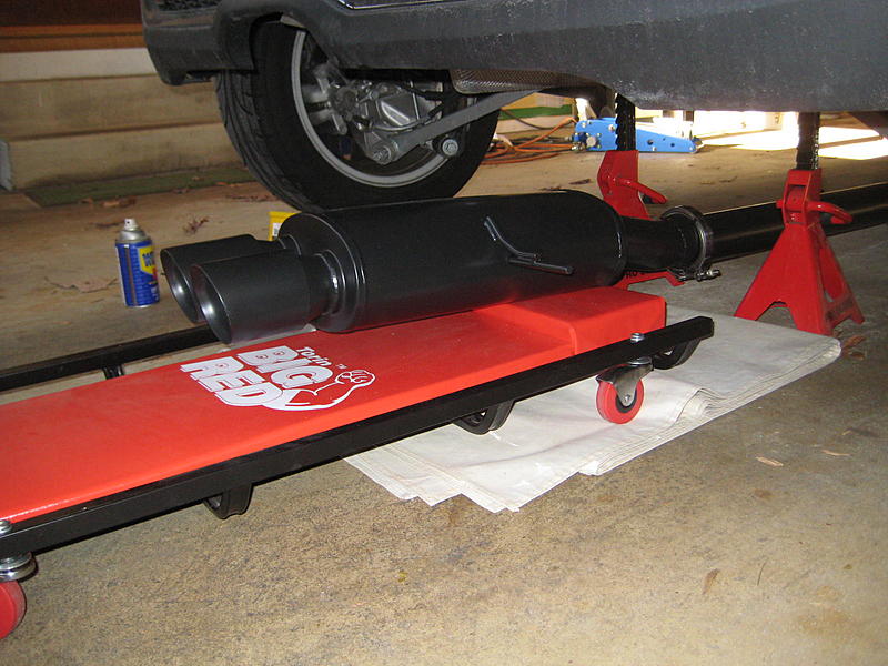

I just installed
an Alta cat back. I purchased the dual tip stealth version. Ryephile did a great review in the Alliance Mag. In fact, I am in complete agreement with most of the comments and observations he made. It is very well made and is very easy to install. It is my observation that it is a tad (couple of pounds) heavier than stock, but the weight is in the larger pipes and more substantial resonator. The fit is as good as you can make it. By this I mean the sections can be turned to fine tune the fit, but this part requires some patience if you don't have another set of eyes. Lots of back and forth under the car to check out the proper alignment. Ryan (Ryephile) had issues with cutting the bracket which I didn't. If you don't have a body kit, there is no need to do this. The slip fit connection to the stock system allows a ton of adjustment. I cut the exhaust in place with a Sawzall and a new blade. See picture of how I supported the exhaust for the cut. I also used the creeper to keep from draging the exhaust on the ground during the install. Also included is a pic of the final product. Yes the car is very dirty. Sorry.
The sound is a great, high quality exhast note. I personally wouldn't want it louder. Driving the car is now much more enjoyable. Tame (but not too tame) while cruising and real aggresive at wot.
Good job Alta!
