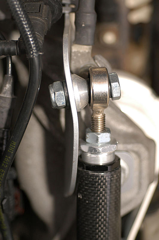

Hi!!
I had bought the engine damper (http://www.txwerks.com/servlet/Detail?no=18) a while back... and though after reading through some forums I realized that I had loosened the damper causing the damper not to do what its supposed to do! So i unscrewed the threads out and tighten up an movement of the engine.
Now this is what happened.. (see pic). This of course was after i went the to track one time.
Why is this happening? Has anyone else has had this problem?
Please note.. i am on my 2nd motor mount as well. Suggestions? I'm going to post Please note.. the damper is not that tight.!
Thanks for any info.

Looks like you adjusted the length a bit to long.
Did you miss a shift? Might have caused a violent move in the engine.
I'd also recommend that you email TSW about the issue.

Nope.. no shift missing.. no poping of clutch no engadging clutch while engine turning off etc... none of that. Lilke i said.. i did take it to the track... im not that gentle at the track i will say that.
Its not too long. i didnt have to tighten that much.

Personally i feel that bar is MUCH too thin.

ok... you cant ask for anything more than this...
Hello Terry,
We had a few MiNI’s with higher horsepower mods (like yours) bending the front bracket in an “S” (like your picture), so we are now shipping a beefed up front bracket. We sent several of the new brackets out to our customers with the bent bracket and it solved the problem. I will be happy to send you a new bracket for free – just email me back your shipping address and I can get it out tomorrow.
BTW – thanks for the picture, it really helps us.

We discussed it last year...He had no doubt in his mind that a 205+whp MINI could not bend his damper frame.

You might want to consider getting the poly engine mount bushings in addition to these dampers.

I bent mine waaay back and never got a "new beefer bracket" and jeff was aware of it. i just gave up the fact i had $125 taken from me for something that does nothing but gives me more headaches than the money i lost was worth. Dont get me wrong...Jeff def tried helping me with the damper but it was useless b/c the damper he used was garbage to begin with.

Hence the reason the damper was redesigned...
FWIW, I was running the original design on the track car up until just a few weeks ago with nary a problem - Dr. Mike still has the prototype on his car after 4 years, with no issues, same performance.

We've replaced all the failed originals, period. If you contacted us, we sent it.
And, you're one of 2 people that have had continuing problems. We bent over backwards to try and help you... 2 replaced dampers, countless internals and at least one replacement bracket...
