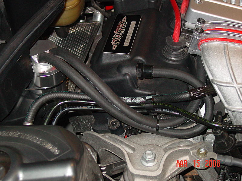

First pic attach post so hope it works.
Here is a nice and clean install utilizing a $30 OCC off EBay, I did have to buy the 3/8" hoses extra though for a few $$. Also, I did not use any hose clamps, it is just not needed, all is low pressure and tight fitting.
I do like those SST lines, very nice dress-up.
