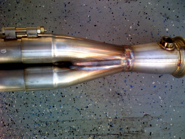

Revolution Mini Works's Avatar
Joined: Jun 2007
Posts: 4,878
From: Irvine, CA
Originally Posted by RickyJCW
Sorry Im not to much into this so I´m sure that I´m wrong. So what about RMW, do they have a webpage?. When I write about header, I mean the collector header, sorry If I didn´t write evrything right. Would you change it?. What kind of changes would I see on my car?. What about doing a re-map without the collector header is it worthy, now that you know what I have in my JCW.
You mean like this?
This is the ONLY tuned header for the Mini
we have them for different cylinder heads, one even for the JCW head

Jan,
What is the purpose of the bolt/jam nut going at the collector interface? Length tuning? Is there one for each of the four header pipes?
Do you have any experience with, or thoughts on, "Anti-Reversion" devices? I know a guy who runs an exhaust shop in San Diego who swears by them, but mostly works with V6 or V8 engines. Would an anti reversion pipe provide any benefit on a MINI?

Originally Posted by ThePritchett
Jan,
it's to keep the interchangeable collector on. We have found by changing the collector we can change the torque band of the power curve. What we strive for with our headers is an extremely long power band at the expense of a "peak" number. As you can see from our track times it plays a part in keeping a longer power curve which results in faster times.
We always ran anti reversion cones on our Big Block chevy's in the old days but we never had collectors as fine as these. Our headers have equal length primaries and much time was spent on sizing and length. Even the degree of neckdown in the collector was analized. I don't want to go too much into it as many $$$$ were spent perfecting this and giving it away is not something I want to do. Also... I doubt anyone will spend the money making this collector anyway as there is no profit in making something this good for such a cheap price So maybe my secret is safe....
I have started on a new collector for the stroker engine as the 1.6L big valve head collector is a little too peaky for my taste on the stroker. There goes more $$$ down the drain in my search of perfection

Originally Posted by Revolution Mini Works
You mean like this?
That's hot.
