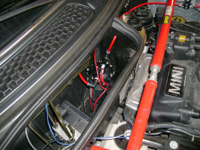

I just installed a "Snow performance " Kit. located the injector in the air horn after the i/c. The tanks and pump are in the rear boot, and the liquid line is under the side trim and seat... I did get the Vari-boost selector ( which I mounted in the eng. compt) , and the anti-siphon solenoid !!
Because the pump is adjustable and the injection has the min/max boost engagement.. I will tune the system ( not the ECU) on the dyno to see where I need to be... But man is there a diff in the 90-100 Heat here in Fl.
Just me......................................

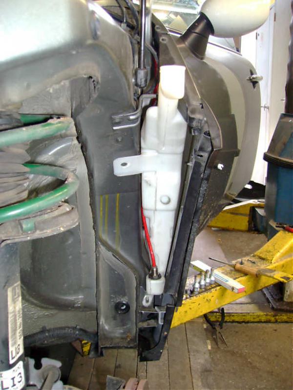

On wednesday we installed the boost cooler stage 2 from snow.
First run with just plain water and the 100ml nozzle, at 20°C outside air temp and full acceleration at 7000rpm in 5. gear, without water 60°C inlet temp and with water steady 44°C .
Attached Thumbnails Selecting a Water/Methanol Injection System-d-senposition.jpg   Selecting a Water/Methanol Injection System-pumpe-eingebaut.jpg   Selecting a Water/Methanol Injection System-tank-eingebaut.jpg
Curious...where are you taking your reading from? My reading always drops nearly 10 degrees below ambient during injection...
We read the OBD output,
just for confirmation this was with plain water no alcohol
and the 100 ml/min nozzle.
