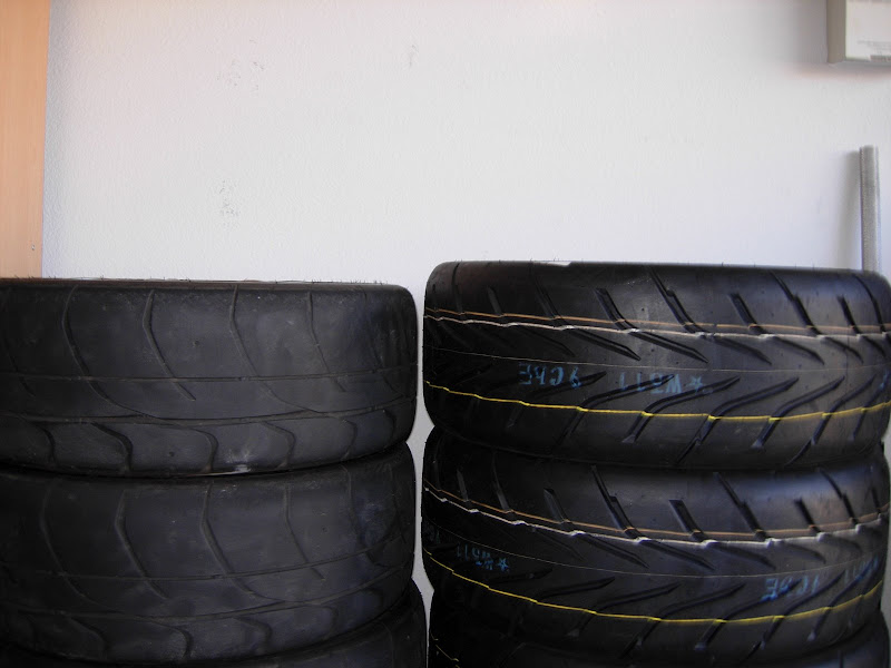

Both of the tires pictured below are the same "size", both are on the same size wheels. The R888's on the right are wider than the NT-01's on the left. Stack is 4 tires high.
Great picture ..... I'm a little stunned. I just had a MAJOR "aha" moment.
Naively, I have been thinking that if someone actually took the time to print a measurement on a tire, they would actually get the darn value correct.
.hmmm, now to go back through posts carefully again as I've just undergone a tire evolution ----

here is answer 1 (tire size)
So on the evolved re-read; this seems to be the answer to the size question:
The sweet spot for tire size on a 16 inch rim would be 225/45r1
The sweet spot on 15s would be 225/50/r1
and, for 17s - 215/40/r17
AND --- actually checking manufacturer specifications is way better than trusting the darn labels!!!!

Okay, so the evolution is a little slow here guys
Originally Posted by txwerks
Actually, the section width on the 215/45R16 is WIDER than my current 225/45R16's, per Kumho's specs, and just as wide as most 225/50R16's (but in a shorter overall package).
Okay, so I'm a little slow ---- Based on the above --- FORGET the labels on the side of the tires -- they are useless.
Just look for a tire that has an OD of 23.9 inches and as wide as you can possibly go ......
Am I getting closer here?
