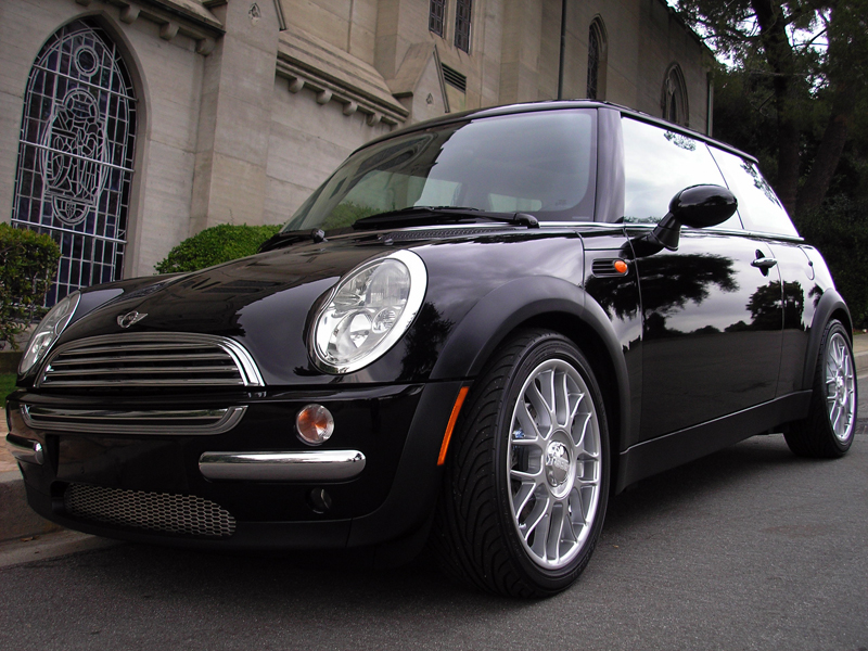

I use Meguiar's 3 step Deep Crystal system. I've yet to see Meguiar's clay bar in the store, so I use Mother's clay. In doing that (comes with their detail spray), I discovered I actually like Mother's quick detailer over Meguiar's. As for Scratch-X, I only use that for fixing scratches, or dealing with spots (water, other-wise). Despite the MINI's small size, I still manage to turn a complete wax job into a two day project... either the whole weekend, or take a couple days off from work. I pretty much just follow the directions on the bottle. I'll wash, clay and polish. Let that sit overnight and put on at least two coats of wax the next day. My MINI is a daily driver, so I find absolute perfection impossible (stone chips on the front end, etc.), but I manage results I am happy with.
