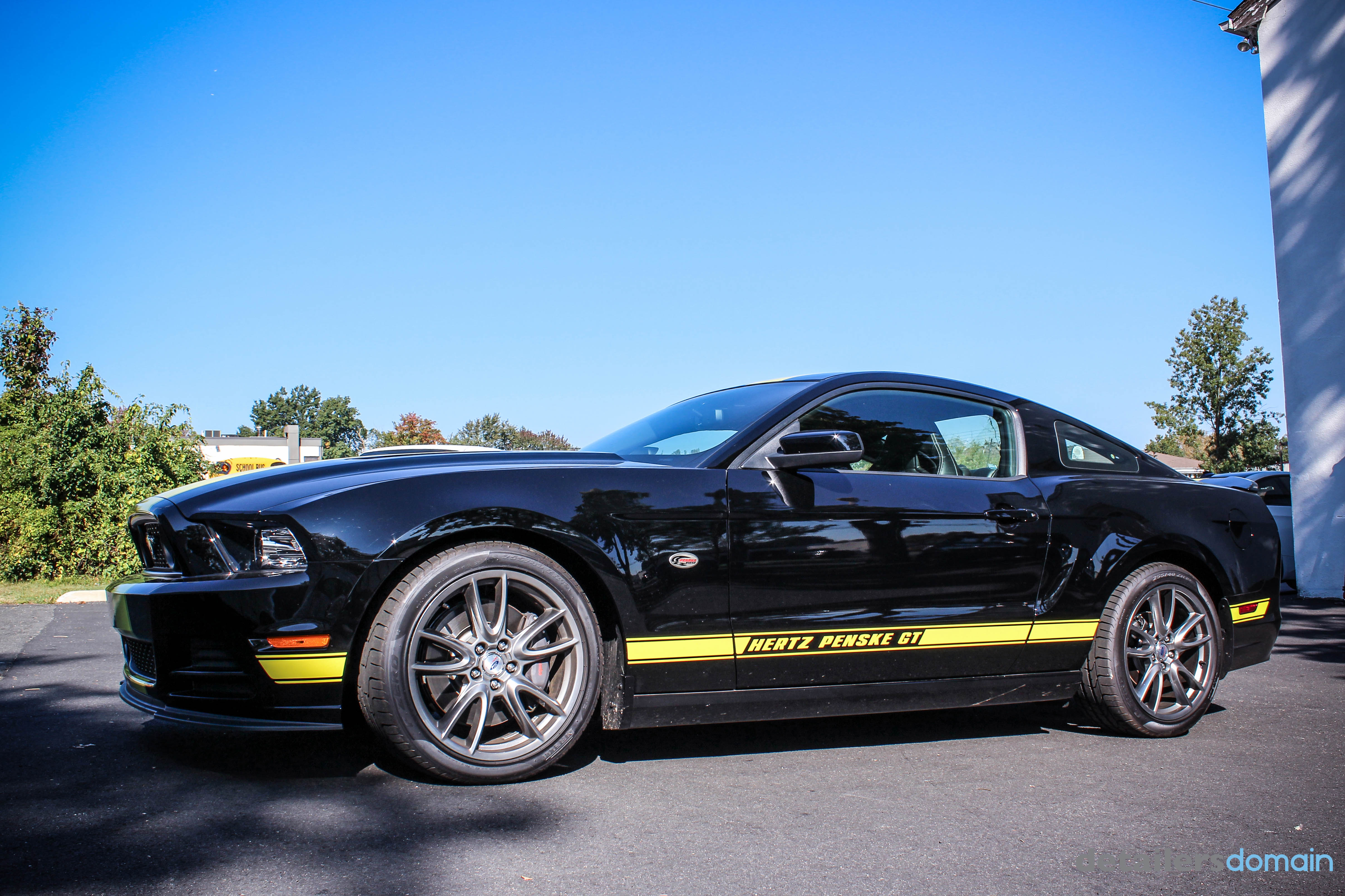

Before

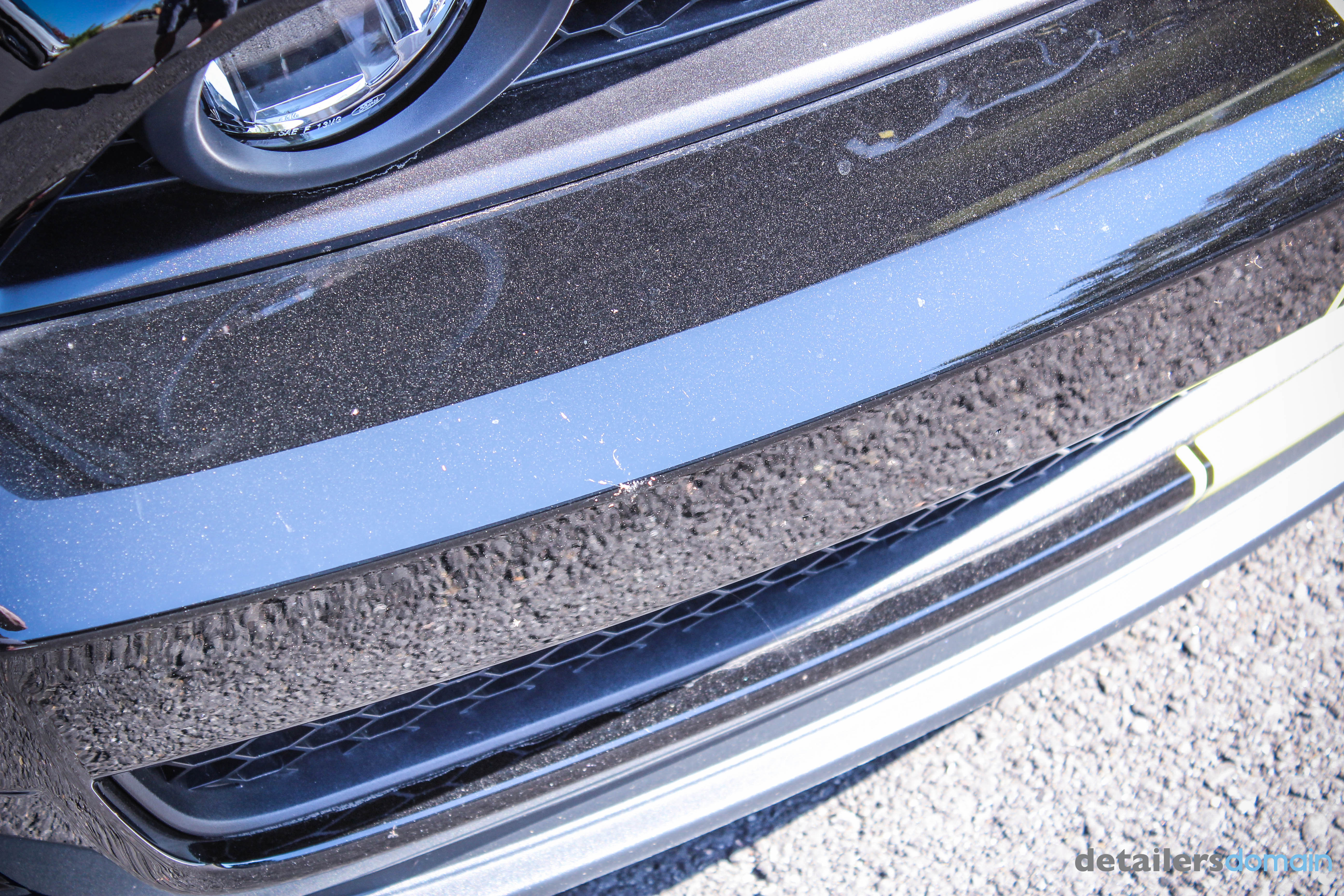

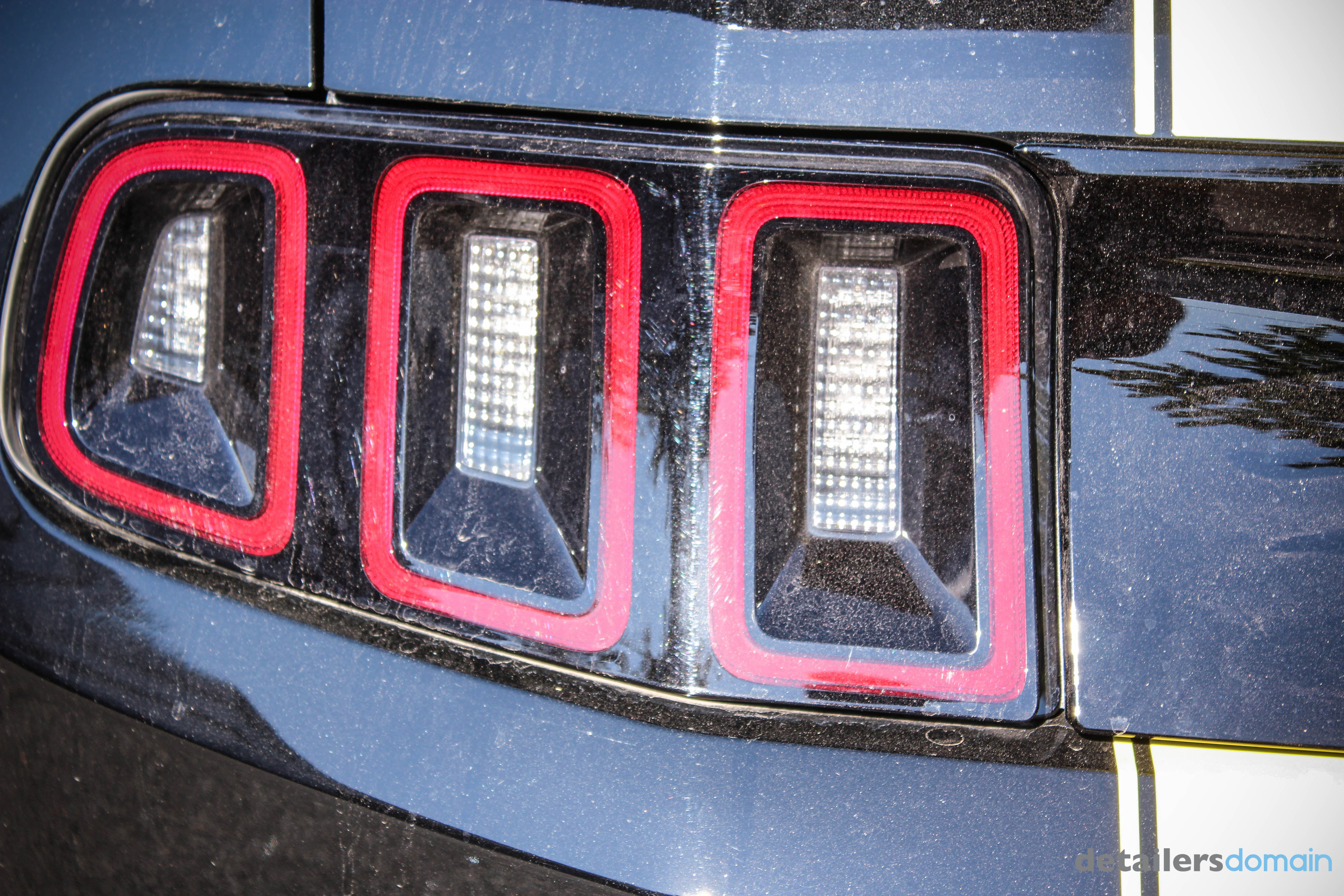

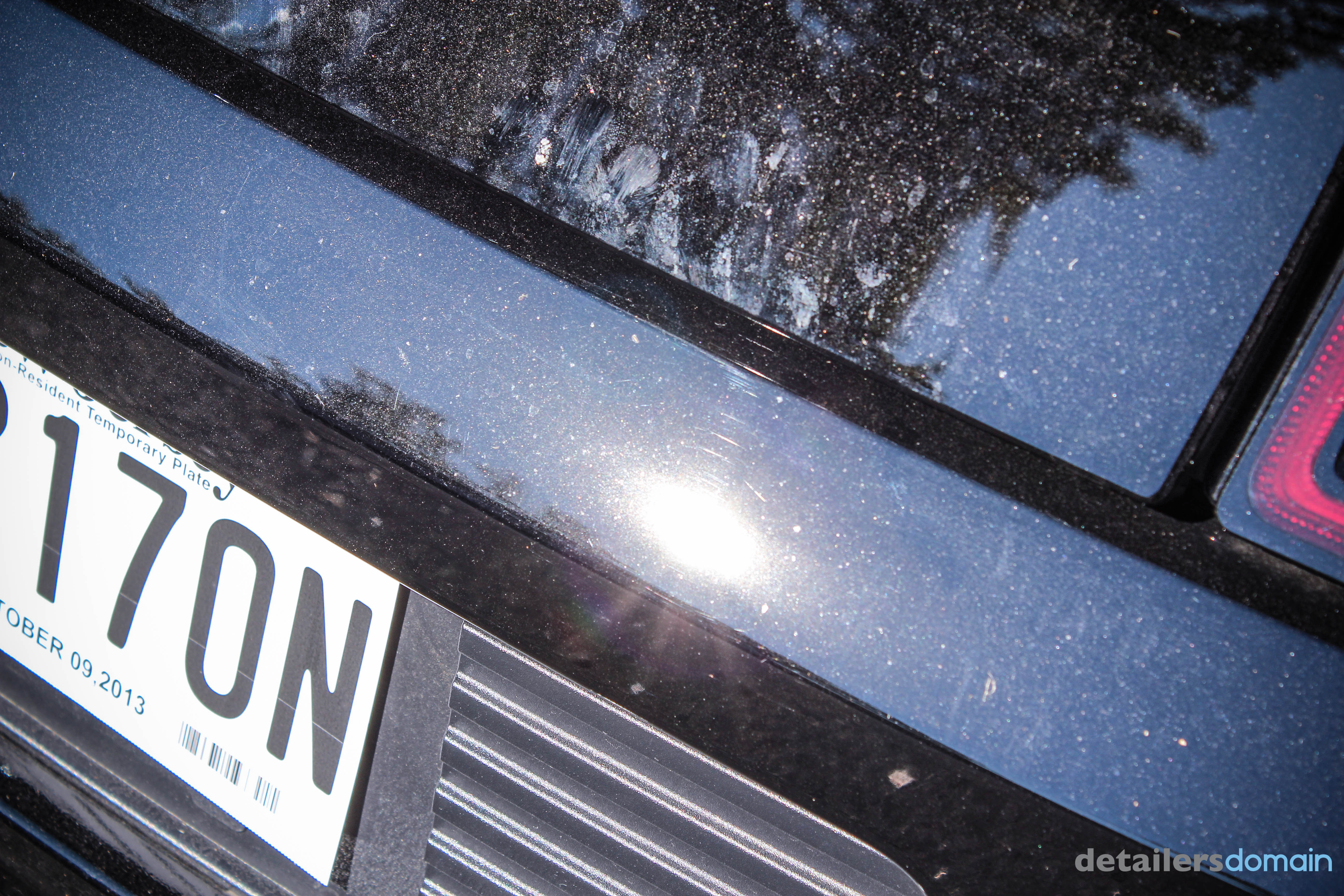

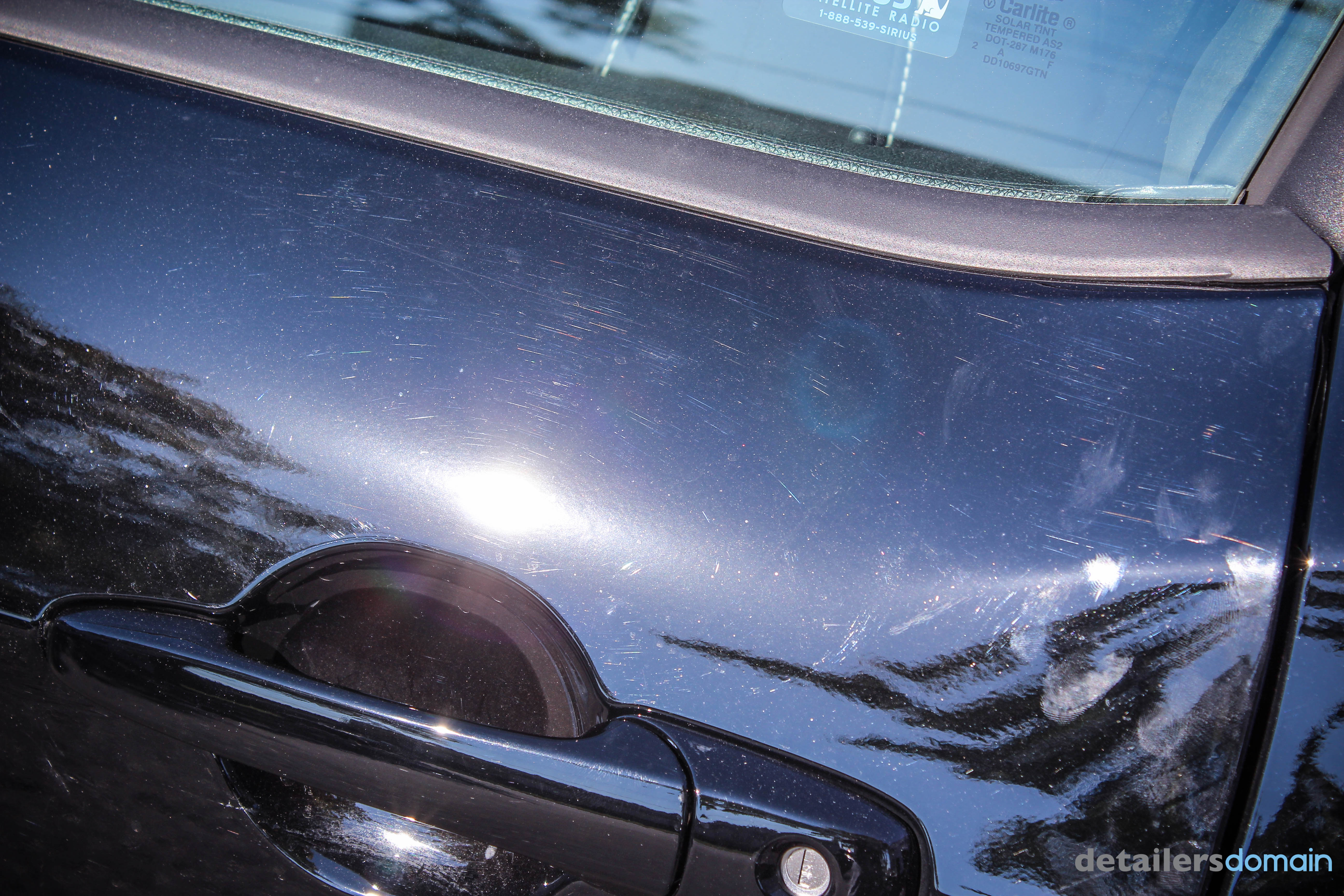

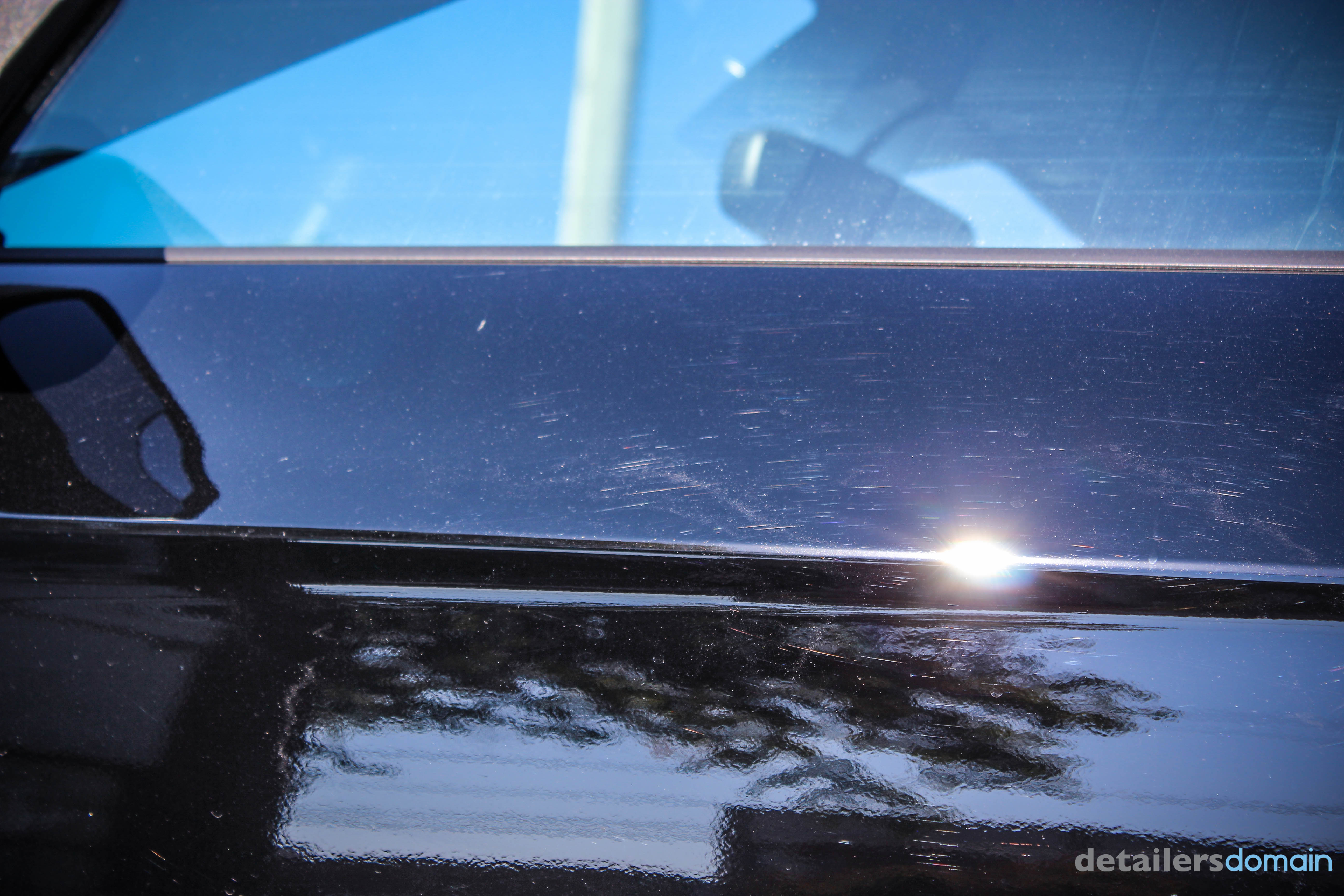

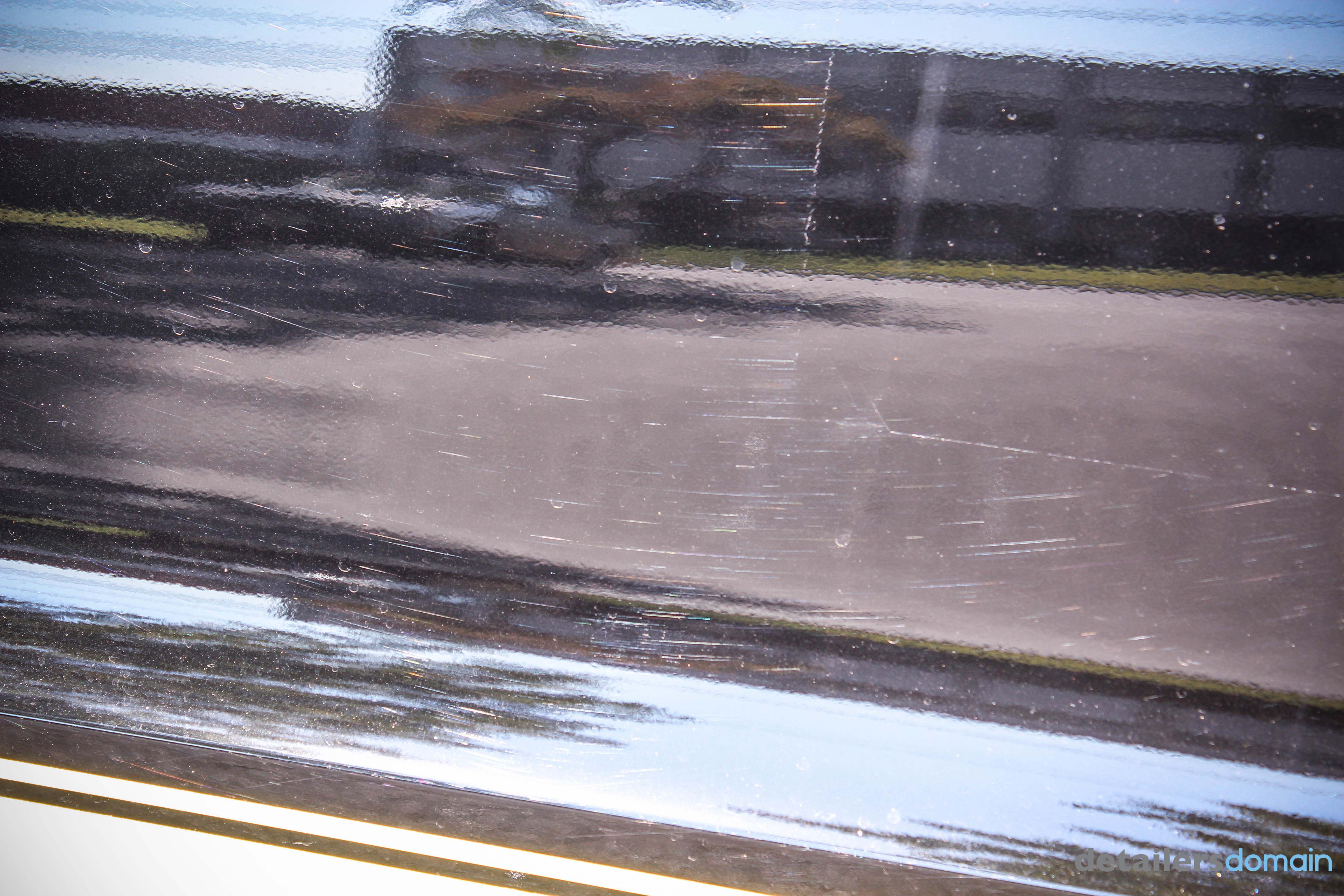

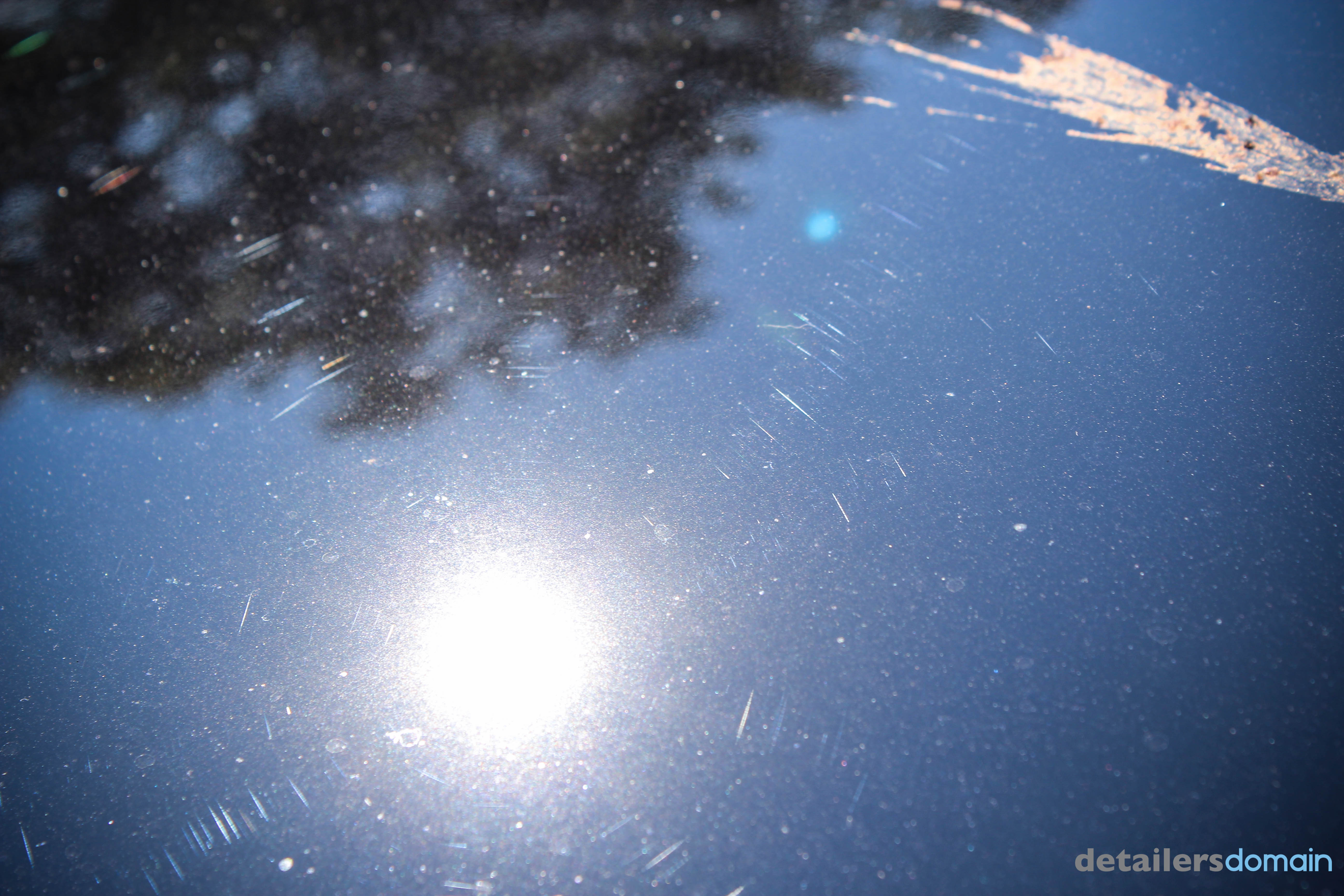

Defects and imperfections were all over the car. Rids, swirls you name it.
