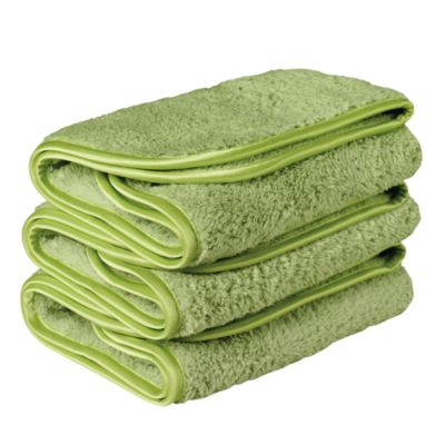

if i was to re-buy all my MF quick detailing cloths, i would get the GREEN colored ones from Griot's. make sure to remove the tag completely.
As for glass, you want to use MF made for glass..it's a very short threaded version. i use the Prima glass towels. works great!
here's the Griot's green towels to get. very plush but not super plush for easier handling. plus you can use BOTH sides.
http://www.griotsgarage.com/product/...rrivals&page=1
You mean those evil sewn in tags aren't a sign of crappy MF? darn
griot's has a 3rd party sew them in. it's a "griot's" tag...
i keep telling them not to do it cause it's just more work for me to remove them.
the MF towels are very good quality. better than the Prima platinums imho.
i have like 30 platinum towels and 15 or so of the Griot's green towels. the green towels win hands down.
