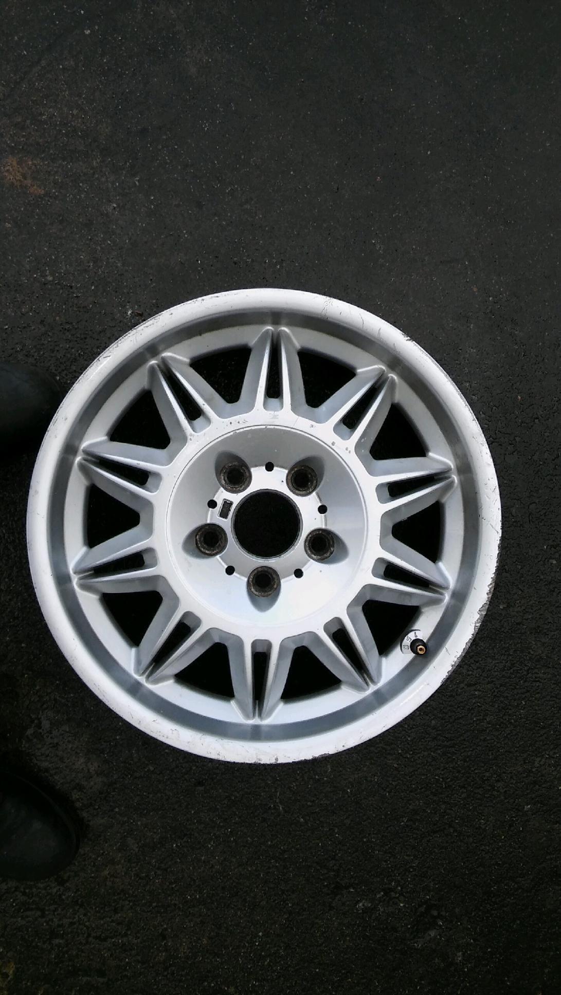

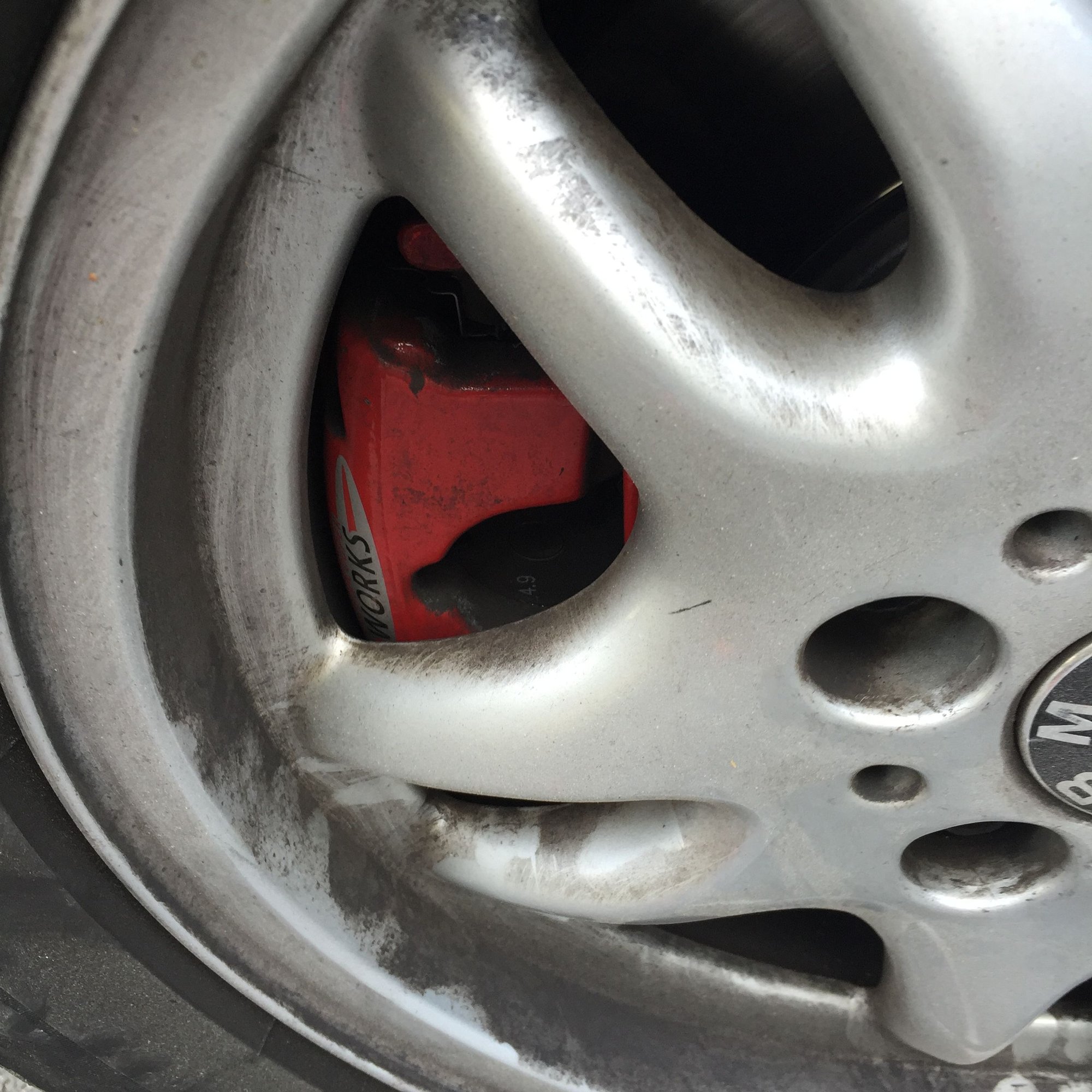

Discovered this today while on my search for winter tire setup...this specific 16' BMW wheel DOES NOT properly fit at all with my 2013 CMS All4 JCW...the offset of this wheel will scrape your JCW calipers...see picture below
next fitting will be with these batch of 17" wheels tomorrow...hope the offset clears the JCW caliper...

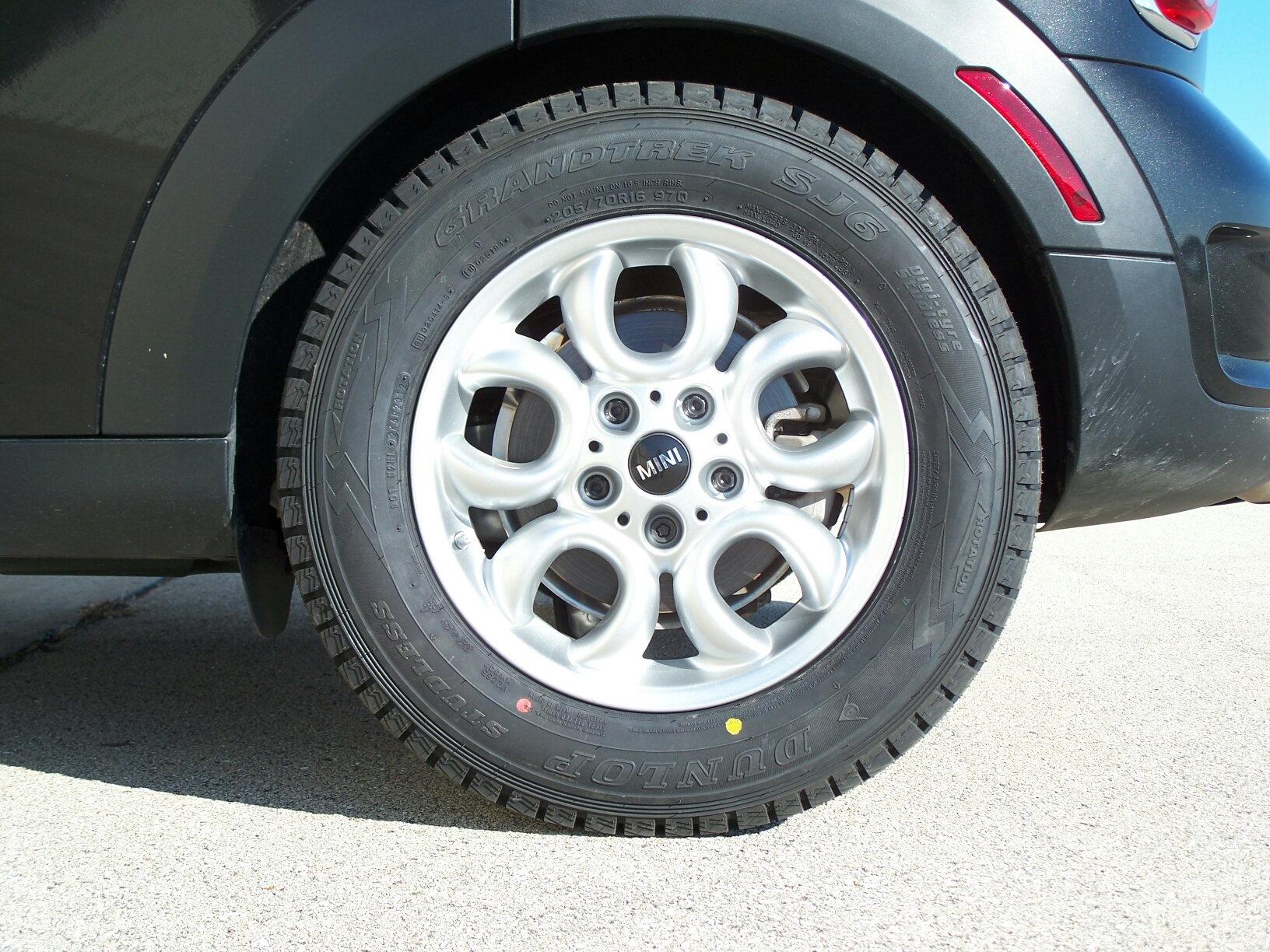

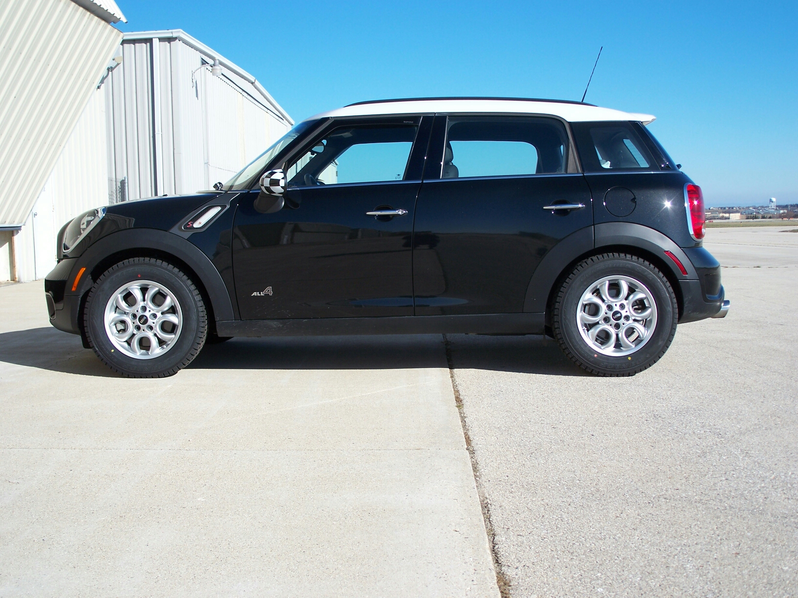

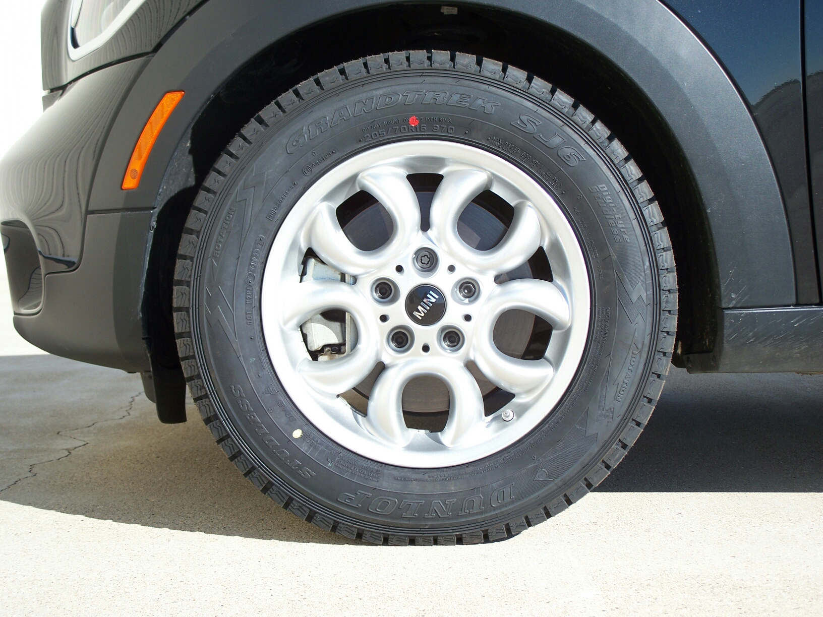

16"-17" wheels on a JCW
here are mini oem 16 inch alloys on my cms all4
16x6.5 et 46
tires are 205/70R16
i have the factory sport suspension

As promised we test fitted all of these wheels and unfortunately these gently used 17" BMW wheels below were NOT a proper fit for my 2013 CMS ALL4 JCW...either too wide, mismatched offset for mini, staggered front/rear, etc....only upside was that my car lift and I had some awesome work out burning calories with the test fitting...
