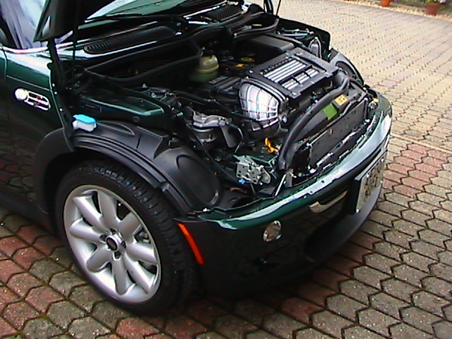

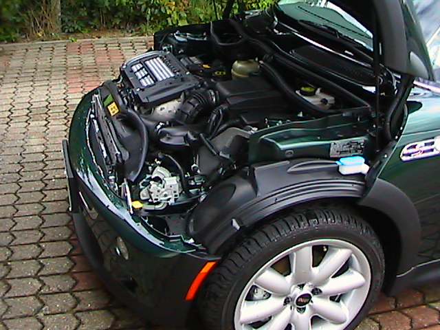

MCS engine bay
its a little tight if i were you check up with m7 see what they can do to help
