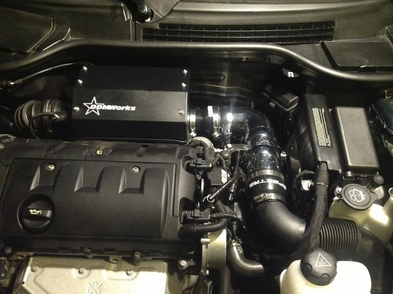

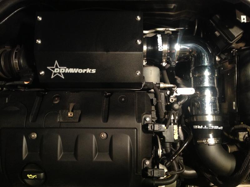

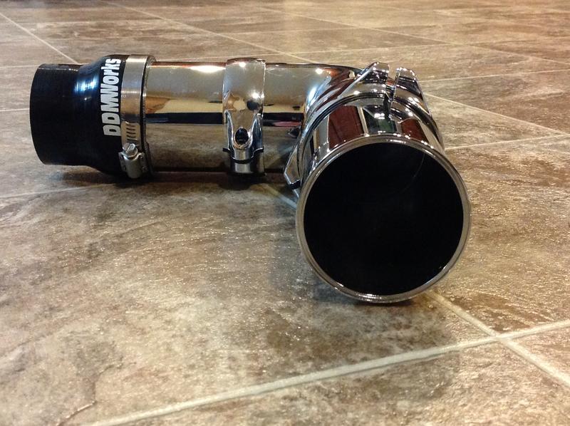

I love the DDM intake!!
Easy to install and sounds great. I made a custom chrome 3" intake tube. This was my first MOD on my mini. Any suggestions for what the next best bang for the buck MOD should be?
Attached Thumbnails VIP/DDM intake, etc...-img_1242.jpg   VIP/DDM intake, etc...-img_1240.jpg   VIP/DDM intake, etc...-img_1246.jpg
Old Dec 21, 2012 | 09:01 AM
Llanrhaeadr_Cymru's Avatar
Llanrhaeadr_Cymru
Joined: Jan 2012
Posts: 488
Likes: 11
From: District of West Augusta
Nice addition of some engine bay bling! Thinking of a DDM myself, just need to get a round tuit.
