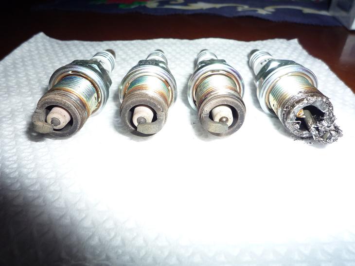

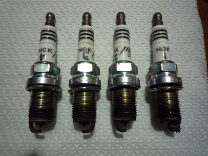

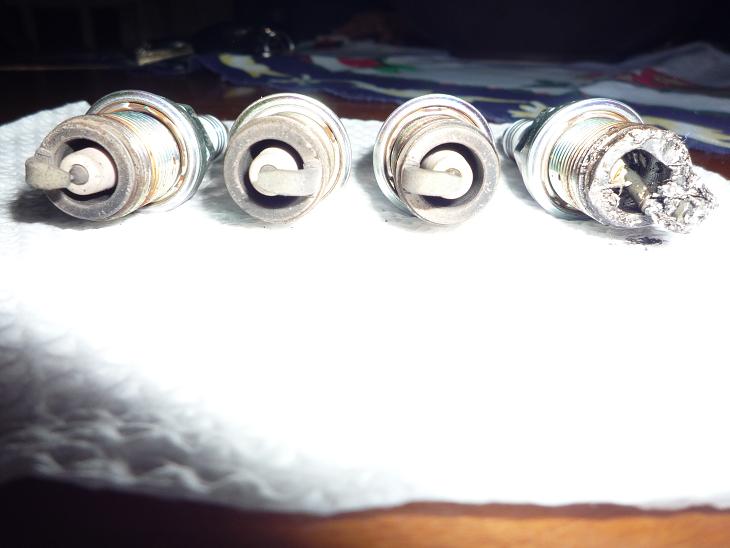

I will upload photos of the spark plugs in a few minutes... they are pretty dissapointing...

Any feedback welcome...
Attached Thumbnails Engine gone :(-p1000792_1.jpg   Engine gone :(-p1000796_1.jpg   Engine gone :(-p1000794_1.jpg

Looks like a broken valve or a ring broke off in that cylinder :(

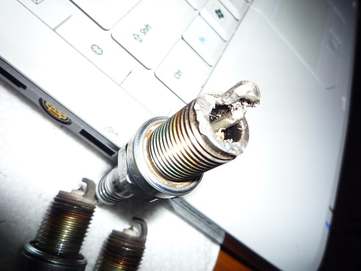

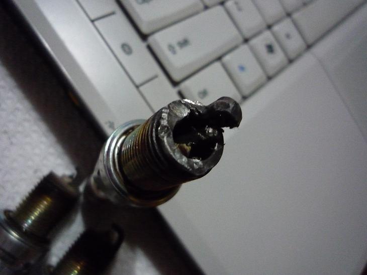

The spark plug in cylinder 1 severely damaged :
Attached Thumbnails Engine gone :(-p1000797_1.jpg   Engine gone :(-p1000798_1.jpg

That's not going to be a cheap fix. We just put a motor in a car that had a broken piston.

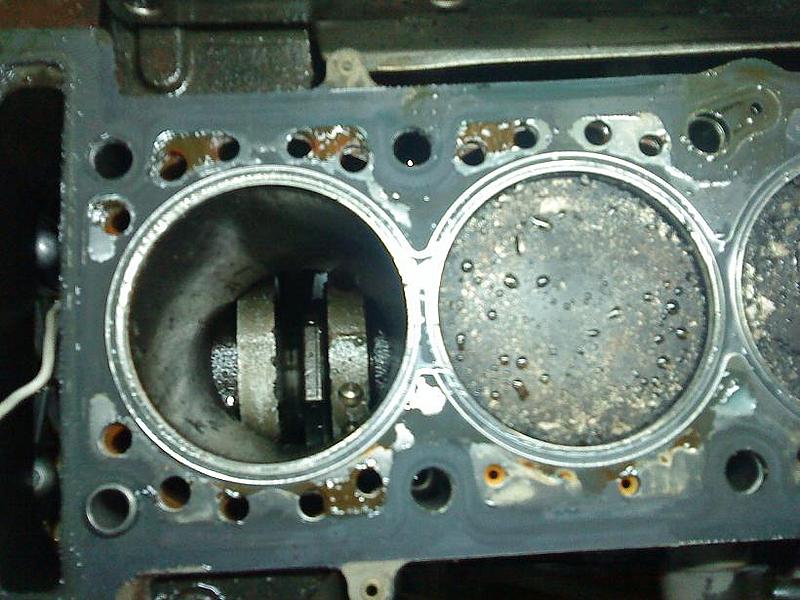

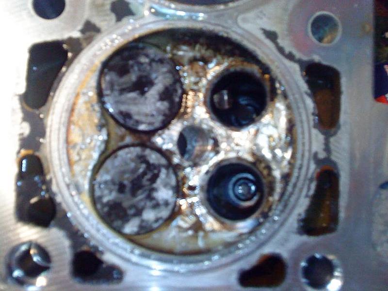

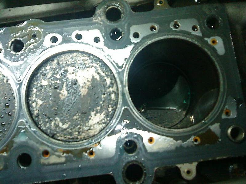

We couldn't believe in our eyes when we removed the cylinder head with my mechanic...
Attached Thumbnails Engine gone :(-dsc00351_1.jpg   Engine gone :(-dsc00352_1.jpg   Engine gone :(-dsc00355_1.jpg

Originally Posted by nickbmw
I couldn't believe our eyes when we removed the cylinder head with my mechanic...
O U C H !!!!!

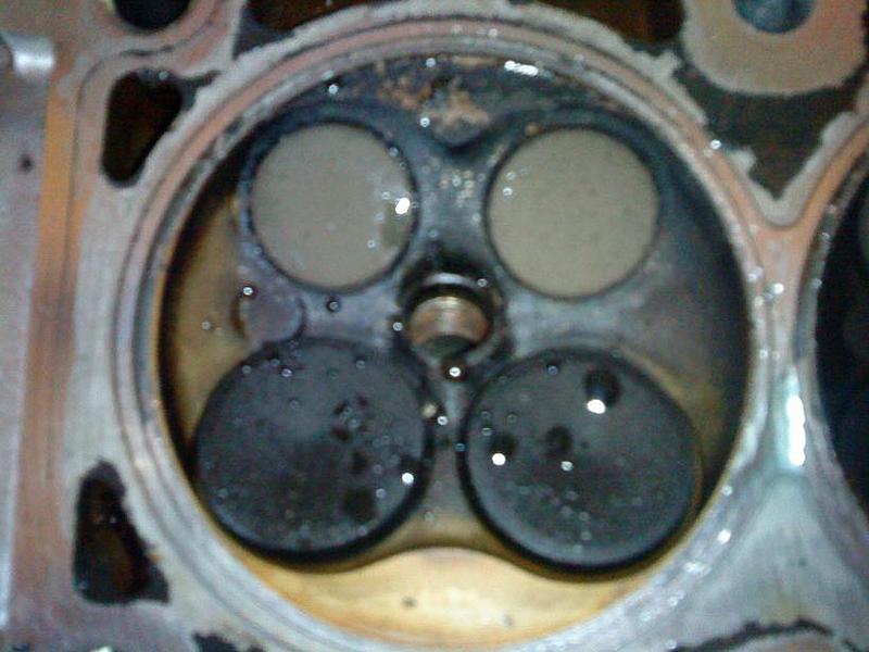

And a few more..
Attached Thumbnails Engine gone :(-dsc00356_1.jpg   Engine gone :(-dsc00357_1.jpg

Sorry to see this... I had a similar catastrophic failure in a built motor (Non-MINI) many years ago due to an oil pump issue.
From your pic of the #1 combustion chamber it looks like both the exhaust valves broke in different places & the stems are still in stuck in the guides. Check the entire valve train, especially the cam caps & journals for galling/overheating & make sure the cam still turns freely in the head. Your mechanic can also put the cam in a lathe or some V-blocks & check the run-out to make sure it's OK.
Once he gets the bottom end torn down he can check the rod & main bearings etc for signs of lubrication and/or overheating issues.
To get back on the road quickly, can you use Cooper pistons/rods with the S block & crank? Sourcing one OEM piston & rod might be quicker than waiting for a custom piston set. If the S rods can't be used, Cooper rods can always be cracked tested & stress relieved to improve them for not much money. A good machine shop can do this & balance the whole bottom end as an assembly.
You might be able to get additional feedback posting on Motoring Alliance & Mini-Torque. Good luck, let us know how it goes & get the A/F ratio checked after the rebuild!

Thanks for your help guys, the photos are taken from my mobile phone and are not very clear, i'll take better shots soon with my camera. I don't have egt or a widebang sensor, by the look it seems that the combustion is ok, there are no signs of detonation on the pistons or the head, or on the spark plugs, on the rest of the cylinders, but you never know. My mechanic thinks sth broke down and caused the damage, possibly because of the rev limiter. (7300)
FlyinScotchman, i will check everything you said, to see if it had proper lubrication. The stems are trully still in the valve guides, and they broke in different points. I don't have a clue yet about the block, because it is still on the car and assembled.
Someone mentioned in another thread, that the Cooper S rods are shorter, i will check that. About the Cooper pistons and rod, i don't know how safe it is to use them again and rev high.
