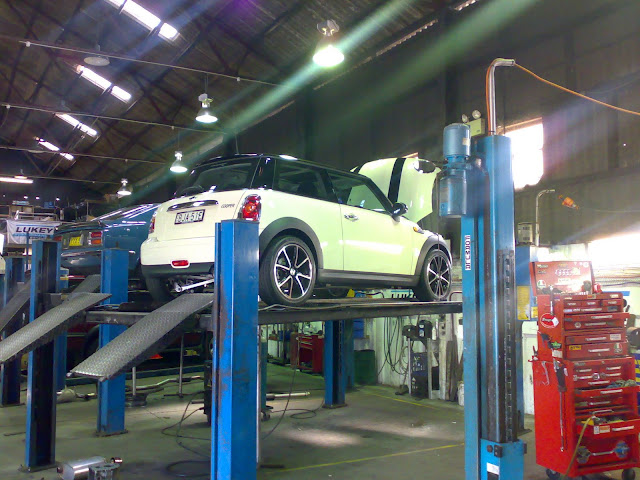

I just had the stock exhaust on my R56 MC replaced with an off the shelf sports muffler here in Sydney by a reputable exhaust shop (Carline). I basically told them that I'm after a muffler that would give me a bit of a deeper tone and improve the flow a bit. Not the racey & attention seeking sound. Although they were a bit unsure of the outcome as they have never done one before, they recommended a type that they think will do the job. Lucky for me it was just perfect! The sound, flow, feel & look I was after.
I no longer feel that I'm driving a 1600cc car but rather it feels more like a 2.5L stock turbo (WRX). And definitely the engine feels more unrestricted and flows a lot better. Just perfect. Cost me a total of A$330 (approx. US$210).
It maybe worth seeking the advise of your reputable muffler shops.
