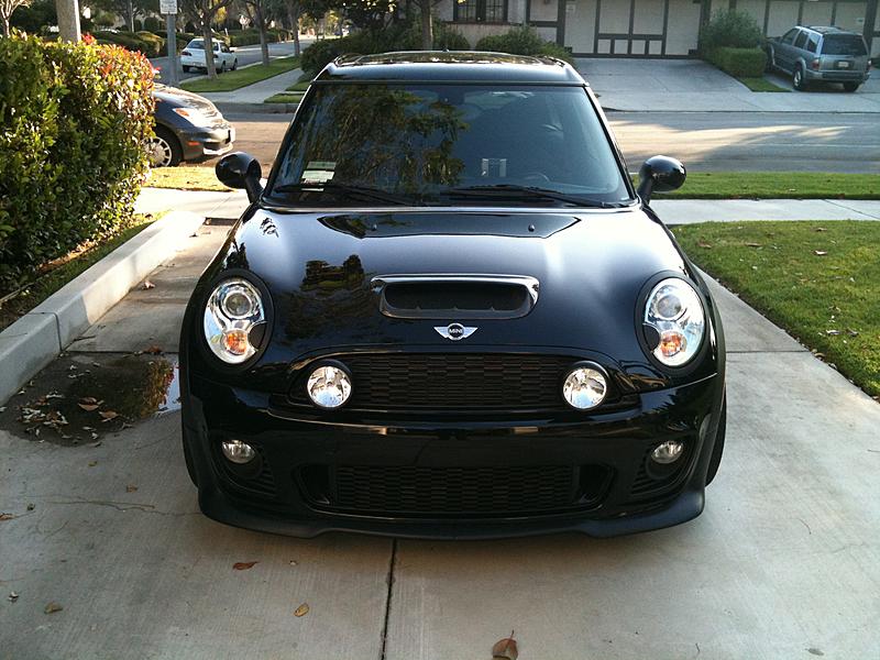

How about these? Fitment was excellent. No gaps, or anything that looks out of the ordinary. The mounting points were exactly where they should be, no need to tweak anything to make it fit properly.
These pictures were taken on different days when I was testing out which side scuttle I wanted to keep.
Taken with iPhone 3GS an hour after polishing the bonnet and waxing with Prima Epic.
