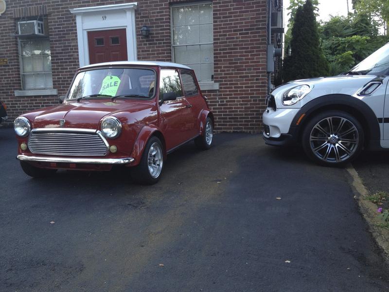

Hi all...
I came across a classic Mini in my town yesterday... I've been desperately trying to figure out what it is... I'm really considering buying the car, I just want to know what it is before I do. The used car dealer does not open until monday, and I'd like to be able to call him as soon as he opens saying I'll buy the car.
It's advertised as a '71 (Probably re-vinned so it could be imported into the states). I'm guessing it's from the 90's as it has reverse lights, the bonnet release is inside, and the door hinges are not on the outside. There is one thing that is really confusing though... It says it's a Sprite on the back 2 rear 1/4 panels, naturally I went and looked up on Wiki what the Sprite had in the package... Apparently they were made in '83 and had a black grill. Now This one has a chrome grill, different wheel arches, and I'm really not sure what year it is.
I'll attach as many pictures as I can! Any help anyone could give me would be much appreciated!
Thanks,
Kyle

It is possible that it is an 83. But won't know for sure until you see under the hood.
Grilles, lights and arches can always be changed.

Looking at the car I doubt those are the arches that would have come on either 'factory' Sprite as they appear much wider than any factory arch I've seen. Looking at a representative issue of MiniWorld (july 2012) their classifieds have a section for Sprite model and 3 are shown. Two are 95 and one 96. All have wheels larger than 10" and black narrow arches, and black grills. UK prices are 3,500 3,200 and 1,650
95% of the Minis you find in the US are going to have been modified to some degree so that's not a show stopper, but knowing WHAT you looking at / buying is important.
What dash does the car have and what engine specifically (SPi)?

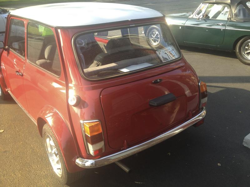

Well I'm taking it for a test drive tomorrow morning... The dealer left the boot unlocked so I learned the trick of those little numbers on the back of the boot latch... It was made in week 7 of year 94!

You mean the stamped metal on the boot latch? That would suggest that the latch was manufactured in 94, although it's possible that it's the original latch. Is there a part of the body that's stamped? I don't know about that. Both the boot lid and latch are easily replaceable.
In any case, it's not a '71. '83 likely, but not '71. Does that mean anything important? Not really since most parts are interchangeable, but things like door handles and much of the interior from a '71 will look considerably different than those from '83 (or '94). Drivetrain will be very different, but body stuff will be the same.
If it is a '94 production year car, than it was illegally brought through customs. That shouldn't be a problem since it's already been registered in the US (it has, right?)

From what I've heard, they only stamp the latch when they leave the factory. If you replace the latch it won't have the year on it.

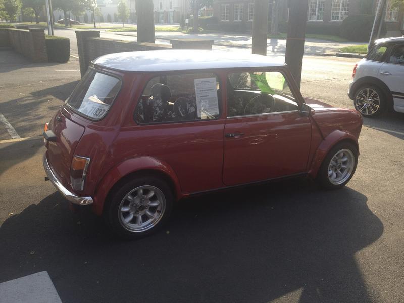

take a look at the wiper motor cover this will have a date stamped on it.....also the boot lock latch will have a date on it the doors under the door card have a no on them................from the 3 pics I would say a late 1995-2000.....as this has sport pack arches and 6"X13"s........does it have a carb......single point or multi point I very much Dout if its a 71......

Judging from the interior of this car (from what I can see through the back window) there is no way its a latter generation 1995 to 2000 - I would say its late 1980's / early 1990's, possibly 1990 or 1991
