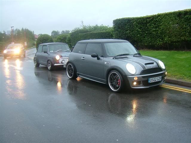

As you guys will know I’m a classic mini man too. This project has taken 4 months to finish due to work commitments, but now we’re ready to install this engine Saturday.
Pipe work from the carb to the supercharger has been roughened up inside to help stop the air/fuel mix from separating, Inlet manifold from the charger to the cylinder head is made from stainless steel, all welds purged to aid better flow. Compression ratio has been lowered using a forced induction cylinder head, ignition being used is Megajolt, so no need to use the distributor, aiding better mapping. Power hope to achieved? 120-130bhp max – fingers crossed!

Awesome. How's the sound? ...as addictive as your R53, right?
