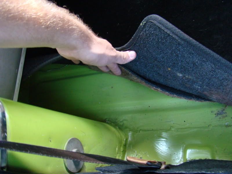

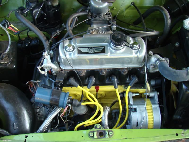

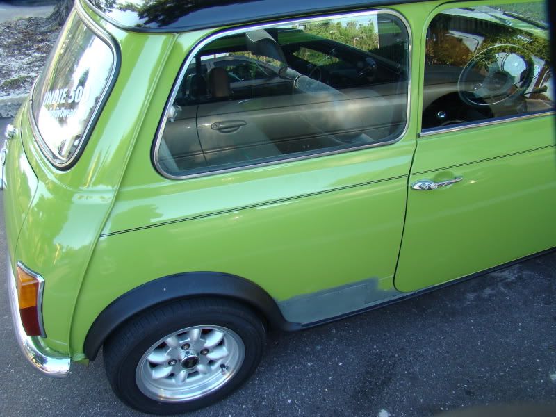

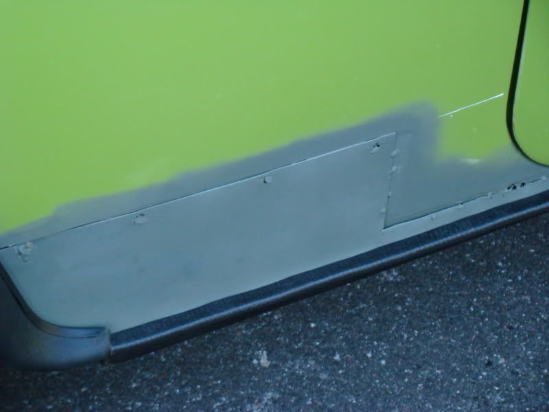

lol just got my mini back out of the shop....had the entire floor replaced as well as the step panels...but added a set of sparco pedals and yellow plug wires...though they did cut and and replace a part of the body that had a huge rust sore...gotta find a body shop to smooth it out and blend the paint...plus i had to replace the battery terminals and clean the rust off the terminals

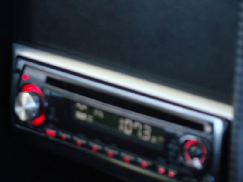

new stereo as the old one was pretty much shot
the rust sore that had to be cut out...

This why I decided to take welding classes .... one short trip around this path sent me to adult education welding school & purchase of a MIG unit ... then replacing a couple of floor pans, some outer sills, some door pocket holes and the occasional panel hole... (cut back to clean metal, cut a patch and use a flange tool to recess it.....mig it in and a wee bit of filler and TA DA)..I think I've come out ahead.

yellowbritishrocket, the new stuff looks great! Bet your ready to get that new metal portion sorted out! Its not too much of an eye sore. I'd still drive the car and not be ashamed.

That welding's a bit rough.........or is it not finished yet........
