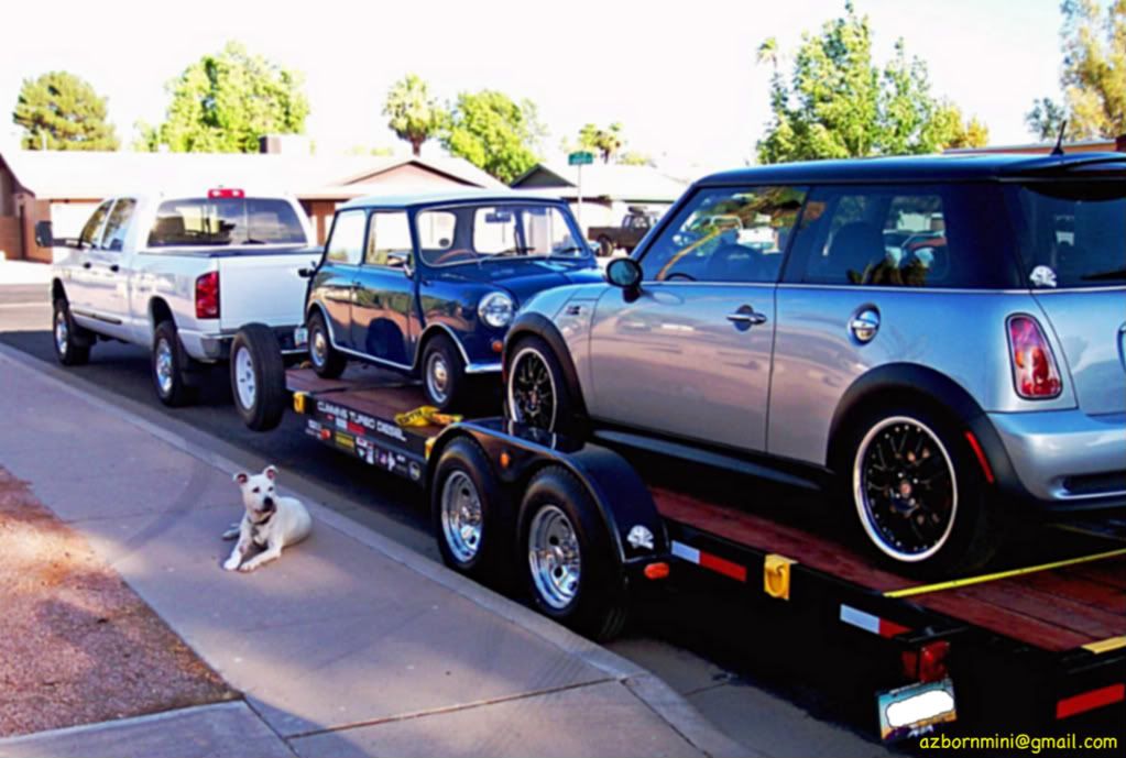

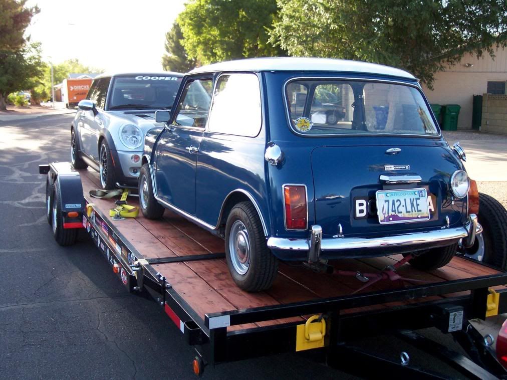

Here is the setup that I use. Has pulled great going to and from MMW 2005, AMVIV 2005 &2006, & MMW 2007.
http://smg.photobucket.com/albums/v2...r%20June%2007/
