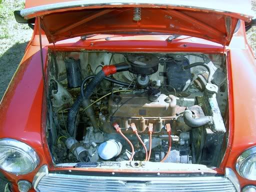

The vin on my engine is a 10H74-3j-h2508. Which I think should be a 1974 1098cc. The car is a South African build so the 1098 was one of the more common engines they used. However, a few things make me believe that it not a 1098. I would like to figure out what the engine is actually from so I can get the correct parts for it.
1) I read that the 1098 engine was supposed to have a removable cover on the side of the block for the pushrods. Mine does not.
2) The oil filter is directly above the starter motor and comes out of the block at a 45 degree angle. The filter goes directly onto the block and the center stud for the filter is removable. I am almost thinking that the filter may have been a conversion from a canister type because the machining of the block where the filter goes looks kinda sloppy and theres a threaded hole with a plug in it that goes into the crankcase directly below the filter.
I searched the web for pictures of clubmans with the 1098 and I could not find one that had a similar filter setup.
Here is a picture of the filter. https://www.northamericanmotoring.co...2_progress.JPG
3) I also was reading that the 1098 should have a crankcase vent from the tappet chest, whereas the 1275 has a crankcase vent from the timing chain cover. I did not see anything that looks like a vent from either place, but I don't have any what I'm looking for.
The casting number on the side of the block is 12G 2398. I could not find anything that linked this casting to a specific engine though.
I also know that the distributor is the regular A series type, not the A+.
I was using this write up as a guide. http://www.mgcars.org.uk/mgccy/pdf/enginehist.pdf
Sorry for the long post, but If anyone has any ideas on what else to look for or any other good references on identifying the engine I'd appreciate it.
I guess the next step is to take off the head and measure the stroke and bore.

The block you have there is refered to as a marina block. I bought a brand new 1300 one, that is currently in my mini. The internals are the same. I believe you have a 1300 as well, because the 1000 and 1098 had removable covers, such as the 1300 did not. You have the right head on it as well. The way to find out what you truly have is remove the cylinder and measure the bore. Hope this helps. If you do keep the engine, I would replace the distributor with a electronic one. It is easier to time and you won't have problems with the ignition. I will post some pics of my engine when I get them uploaded

Miniroll, are you able to get parts for yours? Cylinder #3 on mine has low compression and the exhaust port for that cylinder is pretty carboned up. I was planning on replacing it initially because I didn't really want to dump money into a 1098. I had my suspicions about the engine and now I'm reconsidering. I guess the it will really depend on the availability of parts to rebuild it.

yes, you can get parts for it, it's the same as any other mini engine as long as you know the size....998, 1098, 1275, etc. The internals of the engine is the same, just the block is machined a little different. I like having the oil filter up top. No more taking the grill off to get the filter out!! The engine I have is brand new. I am not really sure about the engine number. Just pm me here and I will identify it.

It's a 1275. Measured the bore to be 70.53mm. Cylinder #3 didn't look bad but the exhaust valve isn't seating very well so theres probably the compression problem.
I put marvel mystery oil in the cylinders when i stored it but theres still a little bit of rust. Is there something better to use?
