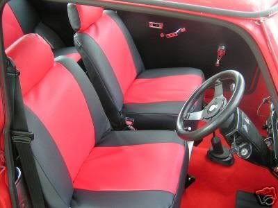

Finally! My replacement interior covers shipped! They look like this, but in black and DARK GRAY instead of red:
She also made me door cards, front and rear, as well as a black leatherette shifter gaitor and e-brake gaitor, all for about $280 shipped from the UK. Not bad a'tall I think. The lady that did them is a long-time supplier to the British Mini crowd, and everyone raves about her quality, so I can't wait to see for myself.

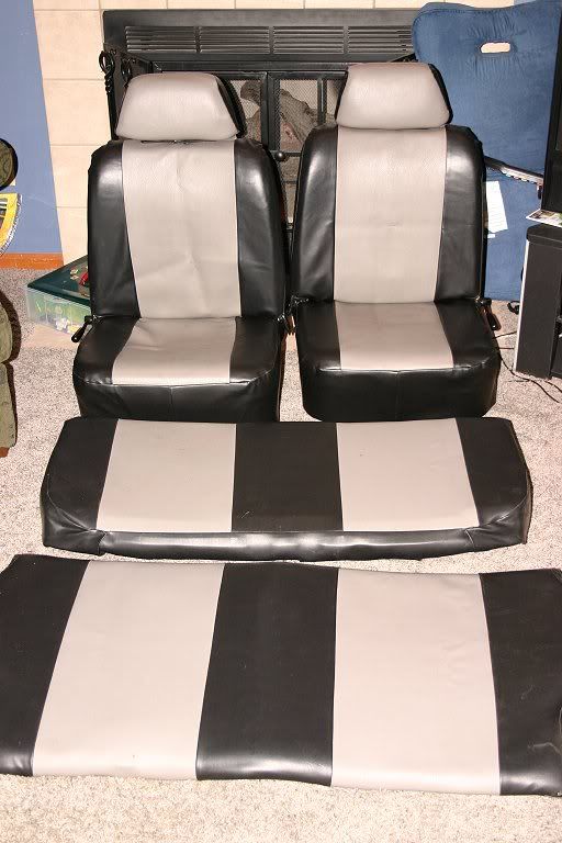

Wow... getting them on was surprisingly easy. Now I have to do all the carpeting though.

Yeah, I'm VERY pleased with them. Really nice workmanship. I'm wondering if I should have glued the material to the front seat cushions, as her covers lack the tensioning peices the stock covers have (they force the cover to suck down to the foam peices) - time will tell and I can always re-do that later if I need to.

if you dont glue them down tightly there is a possibility over time they will rinkle due to them streaching....no so much with the backs than the bottoms, where most of the weight is.......very nice by the way

Good info to have... I'll get a can of the 3M adhesive and plan to spray the seats, then. Hopefully I can get a few more clips as well someplace - the OEM seats have plastic rails sewn in that grip the entire bottom edge of the seat, but the replacement covers are only held by a few metal clips.
Is that the sort of item that a auto re-uphostery place may have access to, do you think?
