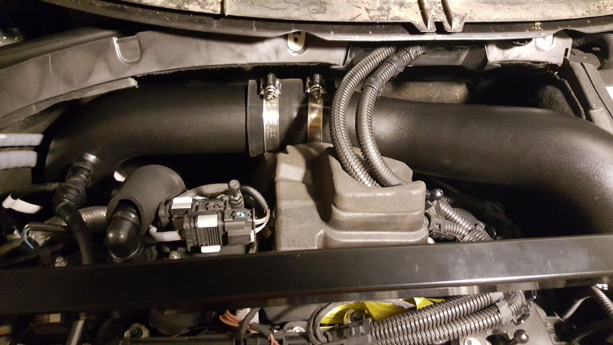

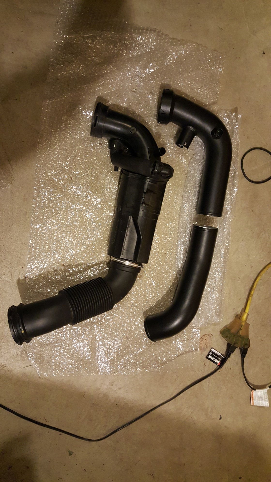

I have and used Forge Motorsport cold air intake Update: AND RACING DYNAMIC boost pipes as a kit. Mine was F60 specific or at least that's what I ordered. Not sure if the other F series will fit or not. Got mine from ECS Tuning and the guys there are great ! Installed was a little finicky getting the OEM plastic piping out in cramp space etc... but overall i like it. Make sure the clip going into the turbo inlet is on properly/tight because you can't see it from above well. I did it by feel. I noticed improved bov sound and slightly better boost onset. Good luck and let us know what you decided to go with.
