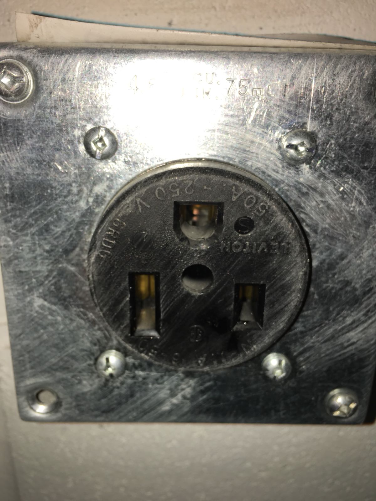

Has anyone try using level 2 charging cord? My apartment building somehow doesn't have 120V charging socket but they have built in the 250V charging socket on the wall. (see pic attached)
Mini only comes with the 120V household style cord but not the turbo charging one. Just curious if anyone comes across this issue and bought the level 2 charger?
I live in Canada and I went to Mini and BMW today they said Canada does not carry this fast charge cable at all.
Any input would be appreciated.

The plug for the Turbocord 240V charging is different that what I see there. The Turbocord uses a NEMA 6-20R plug, though I'm from the US. Here's link to MINI's charging guide site: https://www.minicharging.com/

That helps a lot, Thank you very much!
