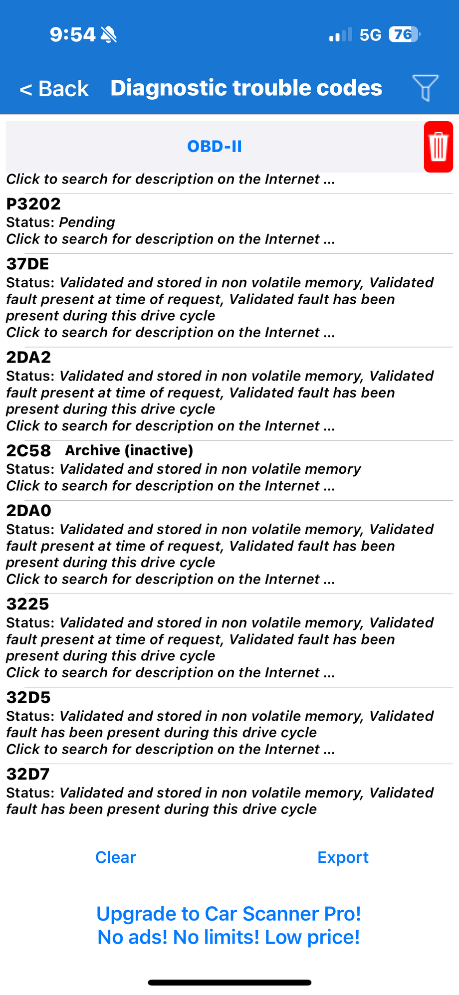

I *think* I do... I was able to read codes on it. I've attached them, but if there's some mini-specific codes missing, LMK how to get those... Thanks!

You can use this site and start working through that list:
https://bmwfault.codes
Do the research and see if there is any overlap, or indication of cam or vanos issues.
