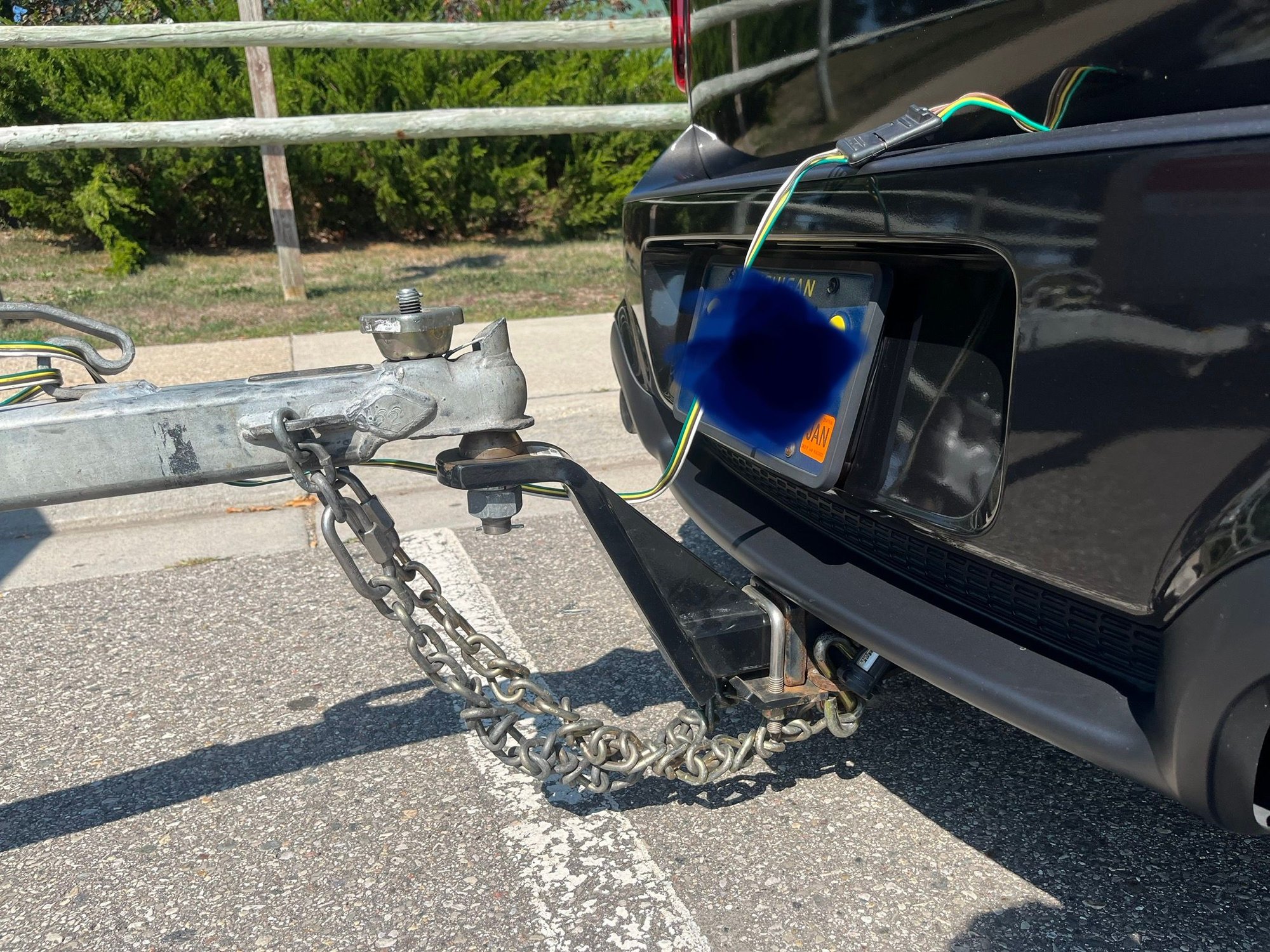

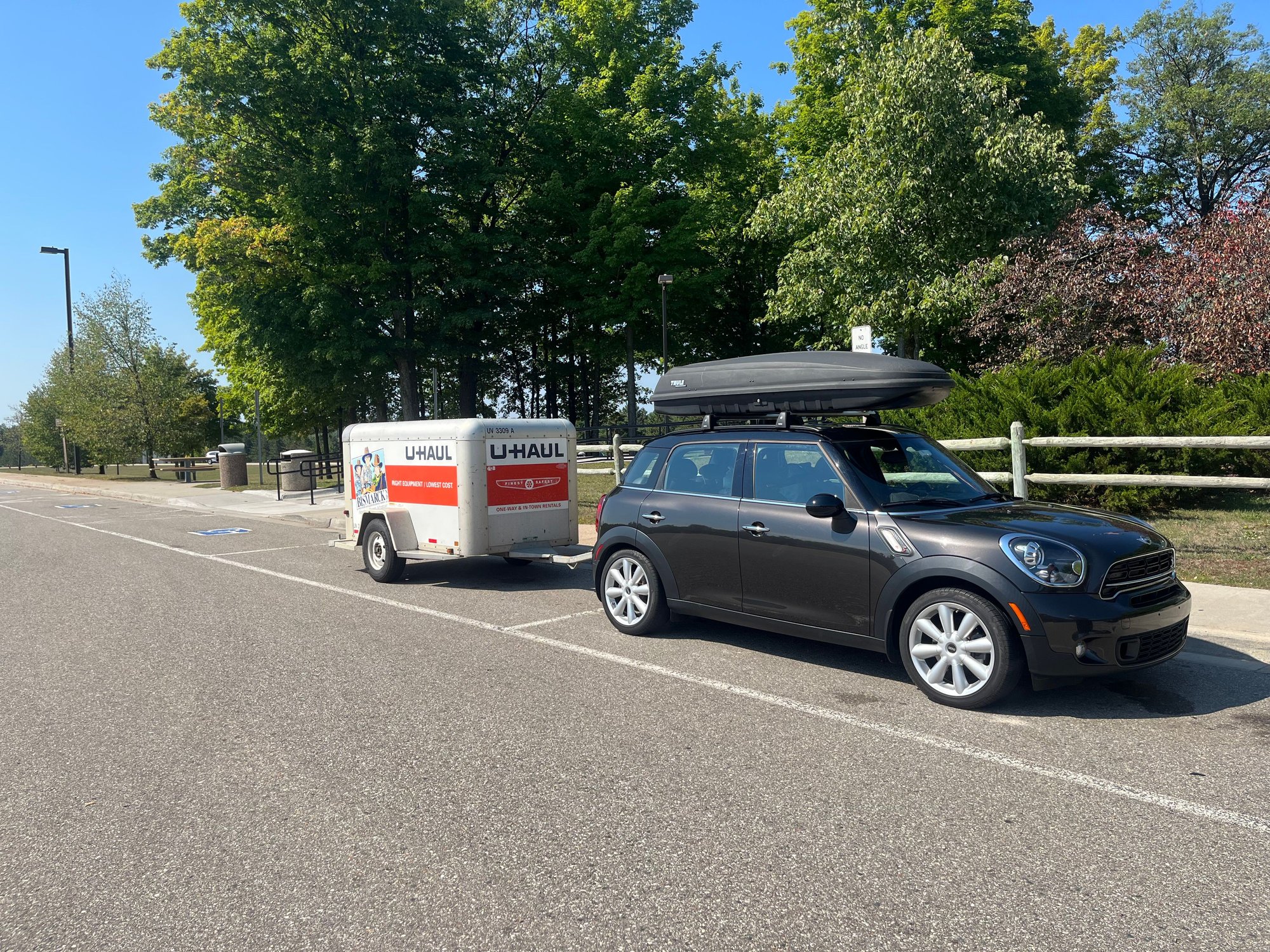

Old Aug 24, 2022 | 04:56 PM
J_Westy's Avatar
J_Westy
Joined: Jan 2011
Posts: 70
From: MI
Originally Posted by J_Westy
I can't speak to the the early R60s, but I bi-annually tow a 4x8 enclosed u-haul with my 2016 to take kiddos to university 8 hours away.
- Ecohitch
- Curt 45090 6 inch riser ball mount
- Curt 59236 tail light converter box
Tows easily and I haven't noticed any ill effects to the clutch or drivetrain.
Took some pictures this time:
