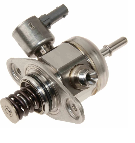

To be safe, 2013, 2014, 2015, 2016 N18 motors should be fine. Note that the R60 and R61 were the only ones with the N18 after 2013.
As a quick sanity check, just make sure that the head has this pump on it...
This pump will not be compatible with your existing wiring...
