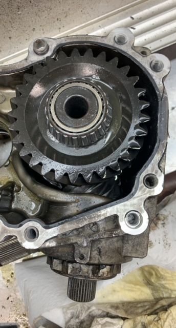

Rebuilding 2011 R60 Countryman Transfer Case
Hello all! Documenting this because I have not been able to find anything online about rebuilding an R60 transfer case. Attempting to rebuild because everything inside looks fine other than the output shaft bearing and I dont want to spend $1,000 + on a replacement TC if I can just replace the bearing. Anyone know how the shaft comes out? Is the 12 point nut threaded or am I missing something? Thanks for any replies / interest.

Update
Just to close out this thread in case anyone comes across it - I don't believe this shaft comes out. Had to buy another tcase after a week of fighting with it!
