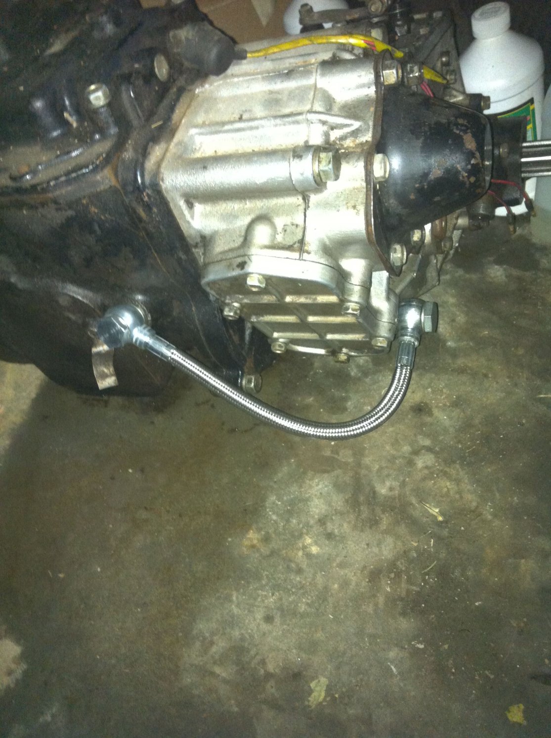

This is what the hose looks like when installed on a stock 1974 FJ40 4 speed and transfer case. A 12.75” hose. I have made them all different lengths for different drives people have installed on their FJ 40, FJ 45, FJ55 and FL60 Land Cruisers.

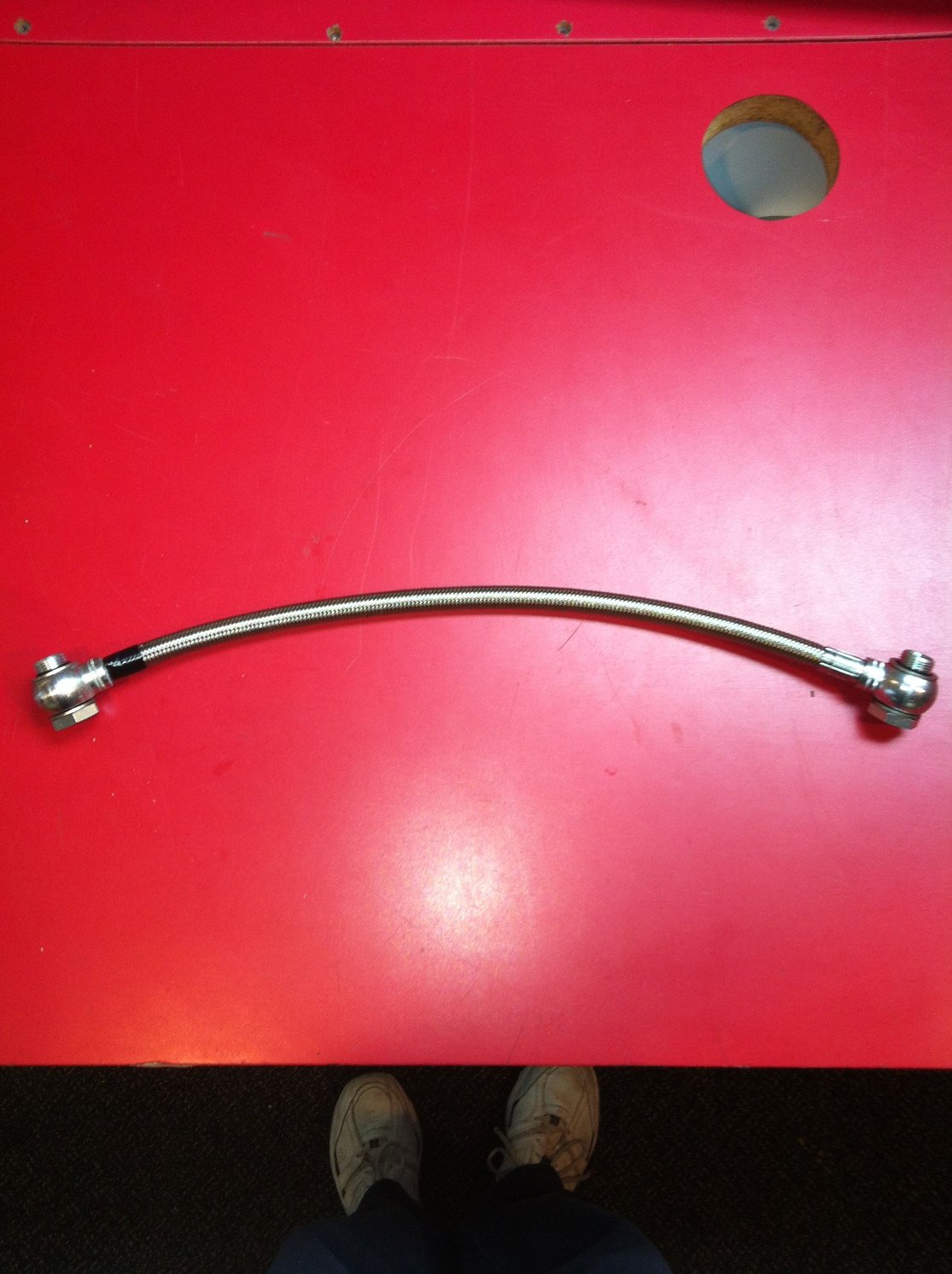

The hose shown is a 17.5”
