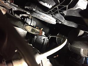

coolant leak
can anyone let me know what this hose is? It appears to be leaking at the connection. Im under the car, front of the car towards the top of the pic (if someone needed to get perspective)

that is the turbo aux water pump
https://www.waymotorworks.com/auxili...9-r60-r61.html
And these are the hoses
I would suggest doing all 3 parts as we commonly see these leak as the plastic cracks on the pump and the hoses dry out.
