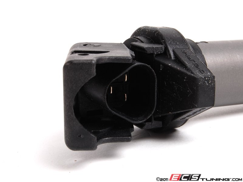

Right. I went with NGK, 95770. Installation went easy but I was still getting a misfire on cylinder 2. I swapped the coil pack with cylinder 3 and the misfire went to 3.
So that mean stuff that coil pack is bad, correct? Spark plugs were over due so that wasn't a waste.
Which coil pack should I be looking for? If possible Amazon is best since they'll get here faster and free shipping. They only carry Delphi brand and from what I've read Bosch is OEM.
Delphi is OEM. You can see it on the upper MINI OEM part Boot. On the plugs one is OEM MINI and the other is the aftermarket Beru. Both made by Beru. Dont forget to get that 14mm socket for those special spark plug 12-point necks.

R60S 2012 with 80,000 miles began stumbling with the big check engine light. Replaced plugs, no change, replaced coil pac on #1, everything fine.
