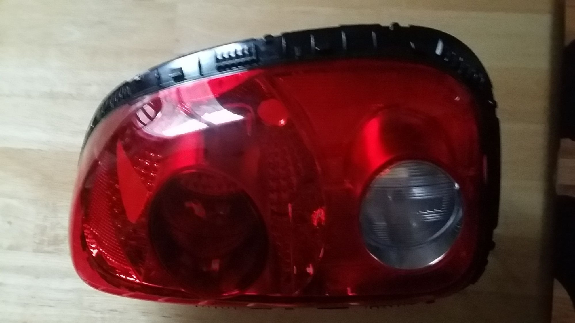

I need to replace the entire tail light unit. The red bubble portion is broken. Here's the replacement part. I just can't get the original out, and I don't see any screws holding it in.
