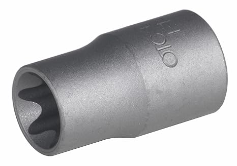

Just got my sway bar for my 2014 JCW..i noticed the subframe bolts are not the 16 MM as the directions..but these star looking things. I have seen and have sockets for the female type star bolts, but not the male type. ANyone know what I need to buy to get these out??

e14 torx bolts.

Perfect! Thanks for the quick response..

I ran into the same problem on my 2014. It seems they changed the bolts for the 2014's.
I went to Lowe's and they had a nice set of the necessary sockets with both internal and external torx sockets.
