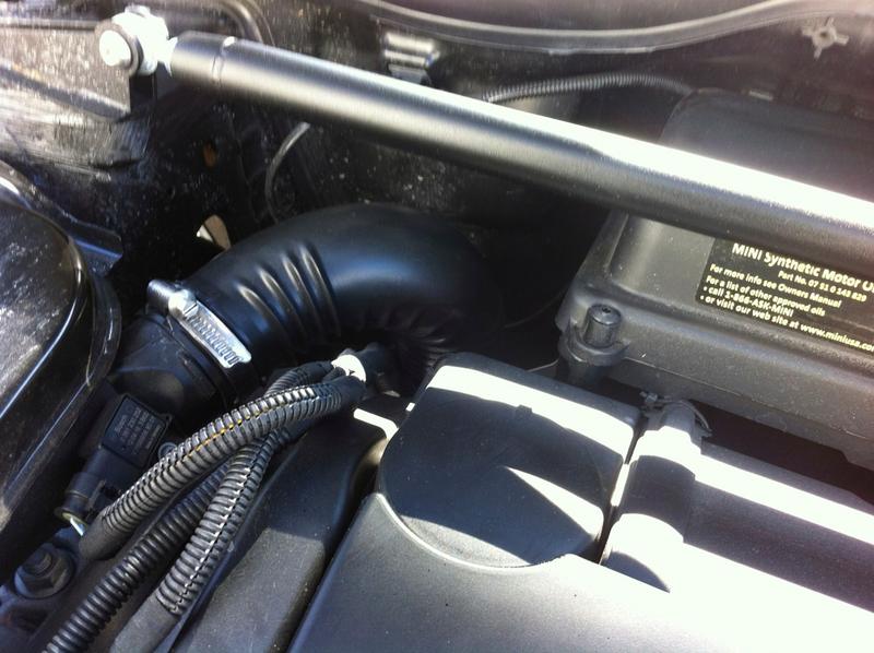

Fellow NAMers I need some help. I recently purchased a SeaFoam fogger kit for the N18 from DOS. Unfortunately, it looks like MINI may have made a change to the intake manifold that makes the kit unusable. In the diagrams for the OEM parts you can see that the intake manifold was made up of 2 parts (parts 7 and 8). In the pics of my intake manifold you will see that it is one solid piece and no longer rubber but a thin plastic. My Countryman is an S ALL4 and was produced in 5/2012. Is there anyone out there that has the same piece that is willing to see if they can find a part number? I cant get access to the lower hose clamp and thus can't get the number myself. Also having zero luck in finding any diagrams that show this piece. Any help would be much appreciated. Thanks in advance.

Weird, mines a rubber hose like the one on the website. Watch out for those venders....

I wanted to add that Clint over at DOS has been great in trying to help me with this. He too has not seen the version that I have. As soon as I can get a part # he is going to get a sample and get me a new setup.

MINI made a some part changes in their recent 2013 N18 engine builds. They are eliminating some of the rubber hoses and replacing them with plastic hoses much like the OEM induction hose.
So far we've seen that they've replaced at least one of the intake manifold hoses and the valve cover PCV hose with this new material. It's a smart move because these hoses should be cheaper to make. Unfortunately, they have not released the part numbers for these replacement hoses to their North American dealer network at this time. DoS wants samples of these hoses so we can measure them, but MINI is not being especially helpful.
cbryantnyc, because MINI can't hook us up, DoS will fabricate a custom hose for you. We will then use this new hose for our 2013+ N18 Sea Foam Fogger Kits.

Same part on my MINI countryman , producted 5/2012.
It's crazy but i changed it by the old part because i've got 2 samco hoses for the intake manifold...
And sorry but i do not have the old hose (-> garbage ), the new, you see ...
"I cant get access to the lower hose clamp and thus can't get the number myself." = to acces it you ahve to pull off the air box to have more space to work and access to this hose clamp

cbryantnyc, I talked with our distributor today and finally found the part number for the new plastic intake hose on your 2013 Countryman S.
We'll ship out a fogger kit to fit your MINI by Thursday afternoon 2/21/13.
