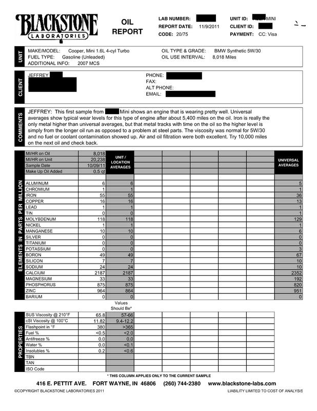

My 2007 is pretty low mileage. The first three oil changes were done once a year at about 4k miles each time. After my last oil change, I ran the oil for 8,018 miles before recently changing it. I sent that oil sample off to Blackstone Labs for an analysis. They indicate normal wear levels and suggested I go 10k on the next oil change and send another sample.
I've only used the MINI branded oil each time, and the car doesn't burn any between changes, but I wonder if this analysis might be a bit skewed because the dealer actually "topped off" my oil, overfilling it by .5 qt about 200 miles before the sample was drawn.
I've attached the lab report and welcome your comments and discussion. This might not answer the OP's question of "When to change the oil", but I think the lab analysis is a good starting point.

Jeffrey, Interesting comparison to my O/A. Which was similar with exception to slightly higher silicon level (which will lower in time), the viscosity, Flashpoint and Fuel %. Just wondering, when you dumped the oil out of the crankcase how long was it since you shut down the engine and how long was the engine running for ? I believe my higher fuel % is due to the fact that I started the CM briefly before dumping the oil to drive it up on the ramps.Originally Posted by JeffreyC

Depending on how much was used when it was "topped-off", this could skew the analysis. I'd figure out how much oil is burned for 10k interval and top it off about 6-7k.Originally Posted by JeffreyC
