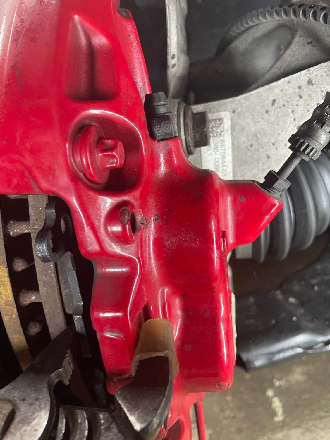

While putting in the track brake pads I had a real Homer Simpson moment. After 6+ years of owning Albert and changing the brake pads I just realized that the front calipers have a depression right in line with a raised area on the brake pad backing plate, both of which would facilitate compressing the brake caliper pistons >>>
JCW caliper with a depression for compressing the pistons
Pliers with a bit of plastic tube to keep from damaging the coating on the caliper
Ok, not the best picture, but at the bottom of it shows the pliers squeezing the pistons back.
DOH!

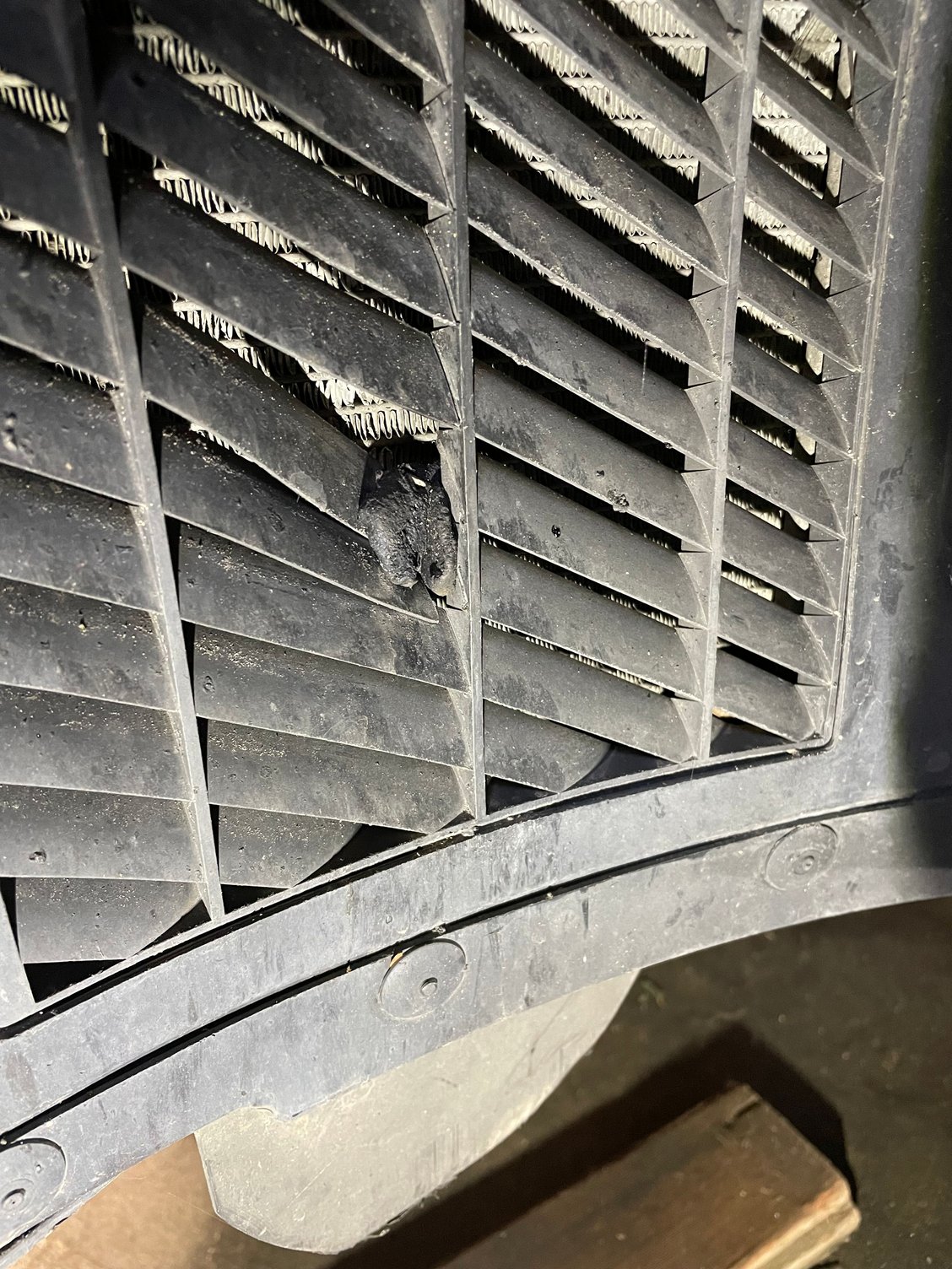

The Gen 3 JCW has an auxiliary radiator that vents into the left front wheel well. When I was checking things over, I found tire rubber slag that was imbedded in the louvers. When I looked more closely I found that all of the louvers in that column were damaged. The plastic seems to have protected the radiator, but I am not sure for how long.
Tire rubber slag damage on the vent louvers for the auxiliary radiator.
