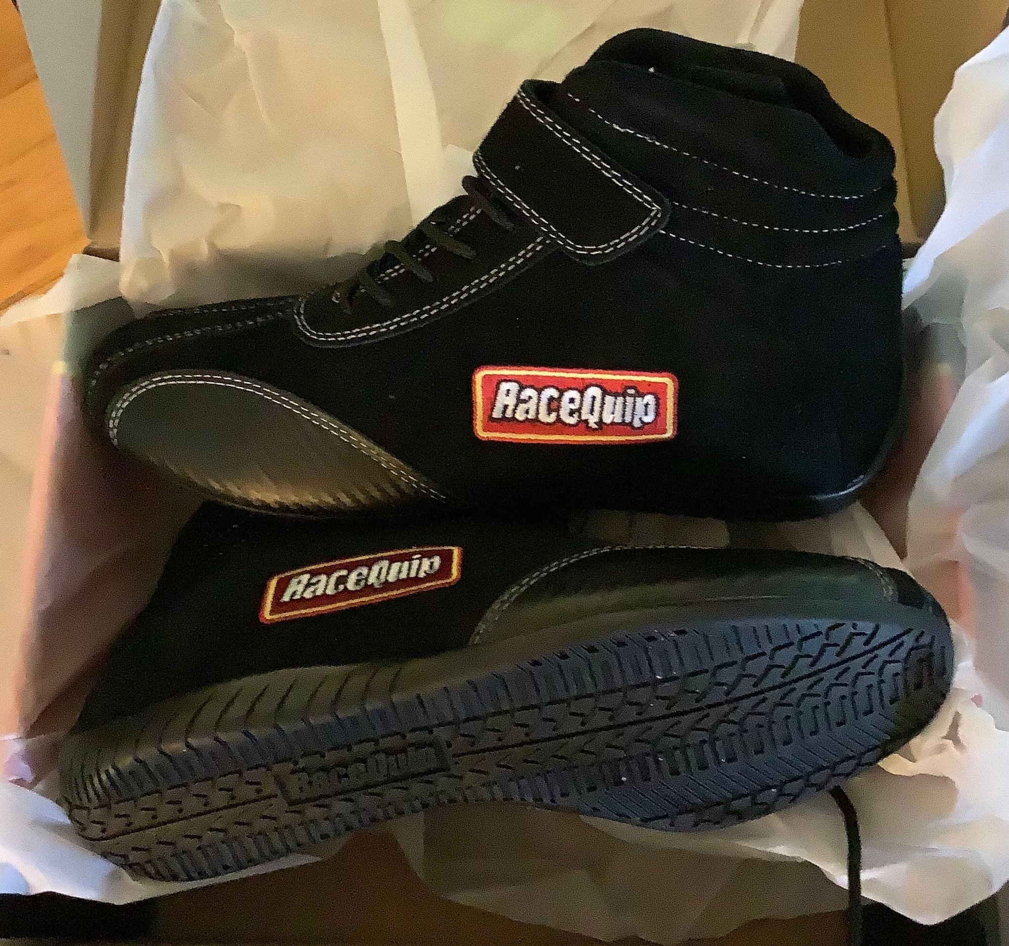

On a different subject - I got new shoes...
Racing Shoes from Summit Racing
My last pair of shoes I wore for the track were basketball sneakers. The problem was the soles got hard and disintegrated. These new ones are full on race car certified and are typically pretty expensive because of that. I also know some places are selling non-certified driving shoes for track day use. When I was searching for the “track day” version these popped up. Summit Racing sells them (as do others) but the thing about Summit was that they carry half sizes in those and no where else I looked had them, even other who carried this brand. Size wise I take an 11 or 10-1/2. I took a gamble on the 10-1/2 and it is perfect. The sizing seems to be spot on. They are a touch on the narrow side, so if looking at these, take that into account. Price on them was reasonable compared to others, but a sneaker will still be less. Summit was very quick to get them delivered. Another Company I have had good experiences with.
The soles are stiff, but grippy and they have a nice heal pad. They seem like they will be good for driving. As for walking in them, not so much. Then again, they are a “driving” shoe, not a walking shoe.

Cool shoes! I was thinking about a pair of driving shoes for longer 'spirited' drives, but then I tried driving in a pair of Vans and that did it for me.

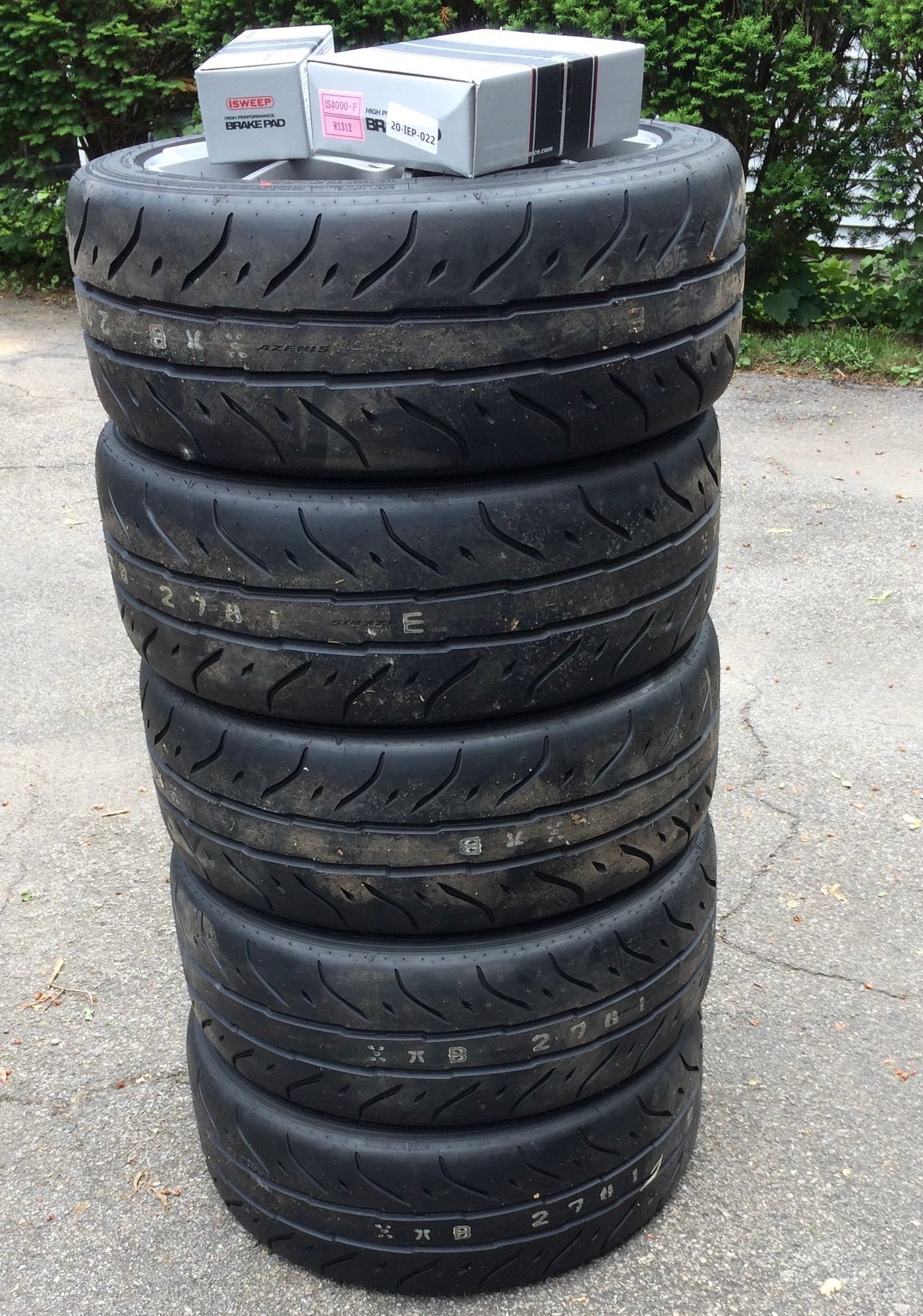

A quick update... For once I am ahead of the game for getting Albert ready for WGI at the end of the month. A new set of 215/45R17s arrived at my tire shop last Friday. I brought the wheels to them yesterday. And yesterday I received the brake pads I ordered. Nice job Neuspeed/NM Engineering...
For pads I got a second set of the iSweep 4000 for the front. For the rear I wanted the same pad, but those were out of stock and would need to be ordered from Japan. This was going to take too long so I opted for the 3500 pad. There will be a slight difference in performance as they are a bit less linear than the 4000, but I expect they will be OK.
At some point I may switch over to the Carbotechs or G Loc pads. They too should be really good and a bit less expensive. The iSweep may be good, but they seemed to wear fast and they are costly.
Even though the dealer just did a brake fluid change, the MINI stuff isn’t up to the level of some fluids, so a bottle of Motul 600 will be going in. That worked well the last time.
From there it will be just drive down, have some fun and return home...

If this were a diner, this would be a stack of pancakes... In my driveway it is a short stack of tires with race pads on top.
New wheels and Falken 660s.. Yup I am 5 wheelin’ it..
Nothing like a fresh set of tires to chew on..
The wheels are 7.5”x17, with ET 48mm. In the front, even though these clear the calipers, it is not by much, so I have added a set of 3mm spacers which gives the wheel 4 - 5 mm of clearance to the calipers. These are in place of the ET40 wheels I had used before that had tire rub in the rear. I am hopeful these fix that rub problem.
I took the car for a spin. The tires do have a “soft” sidewall compared to others. And they ride quiet for what they are. Interesting that they sound like Velcro being pulled apart on some road surfaces.
The brakes are good. Maybe not as solid as they should be, though, but still good. I took Albert to my favorite brake bedding hill (~ a 4 mi downhill run) and set the front bumper done on the pavement a few times. No drama. The iSweep pads feel really good. Linker up front and no drama from the rear. It will be be interesting to find out how the iSweep pads work in the rears when out on the track, but if this ride was any indication, they should be good.
Good to go. Drive what you have and don’t wish for it to be different, especially when there is nothing to be done about it.
I’ll report back when the tires have less tread then they do now...
