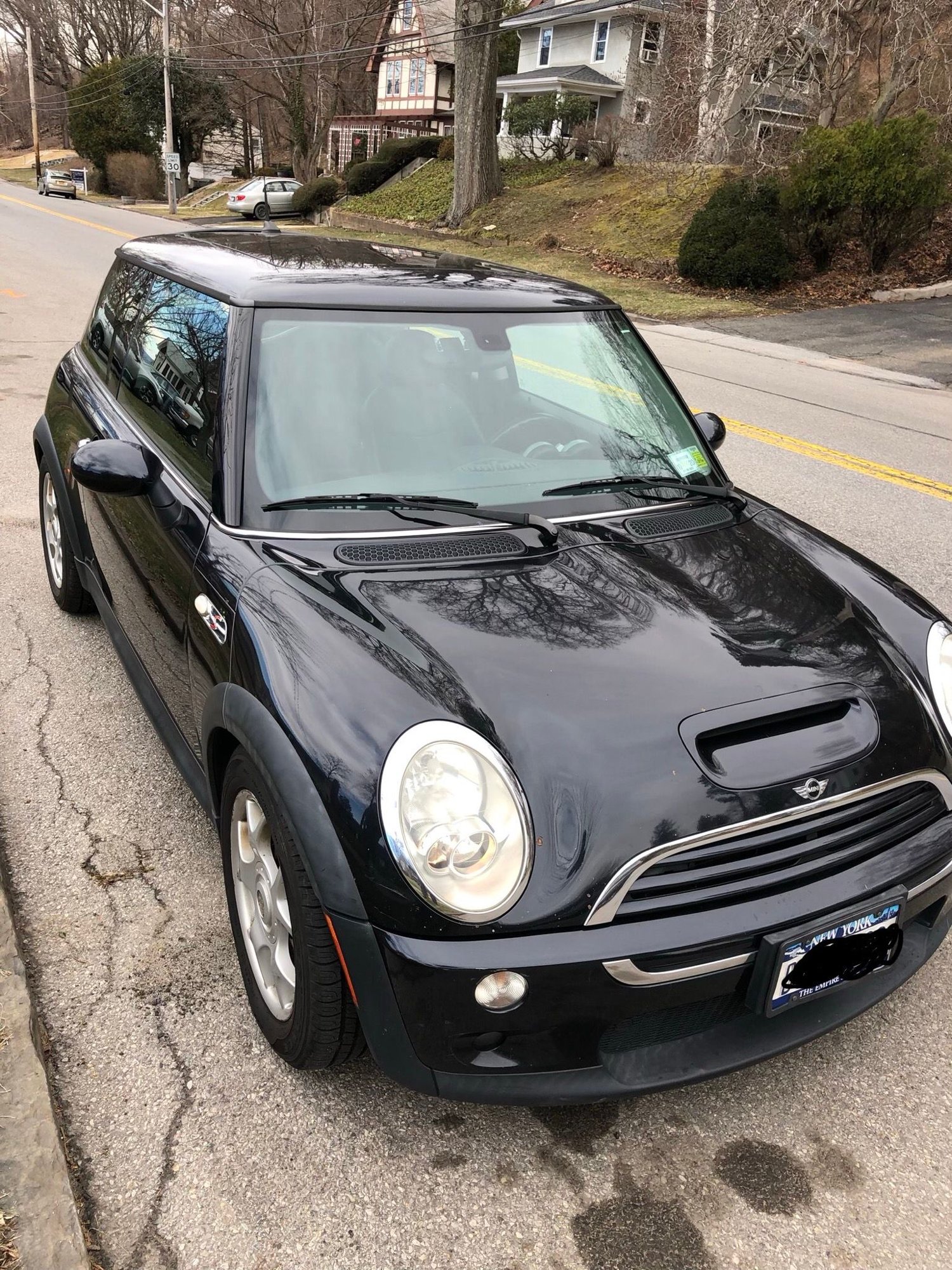

Hi everyone I’m very happy to finally own a Mini Cooper I always look at them but never pull the trigger until now out of all mini I really like the R53. 2006 cooper s but was always looking for one in Black until yesterday the engine it’s in great condition but it have some transmission trouble I got a really low price w the intentions of do a Rebuild on it and refresh all other components that needed attention while they taking the car apart .this it’s my 3er car in the how so it’s no a rush o getting it done so I want everything done before it’s out the shop so if you guy have suggestions on things I should replace and take attention it will be really appreciate.

here where i find transmission fluid ,where this leak may come from ?
Hi Guillo99,
Are you sure that is transmission fluid? It seems to be on the wrong side of the transmission. That looks like it may be an oil leak.
Does it not drive in any gear? Make sure it is not low on fluid and only use recommended transmission fluid, if it is low.
Oil leaks are pretty common and one bad area is the oil filter canister. The o-ring can be damaged during installation. It takes a 36/37 mm short socket to remove it.
A common oil leak is at the crank position sensor under the front of the block, just right of the supercharger.It is an easy fix and usually only needs a new o-ring, but sometimes the sensor leaks too! The valve cover can also need a new gasket, as they all seem to leak at some point also!
The plastic coolant tank on the firewall always fails and can cause overheat and engine damage. Many of us use a metal replacement tank, but make sure to get one with the pressure cap. I use one that takes the original cap. The plastic tank usually fails at the seem and can be had to find, but if you are getting dried up coolant on the aluminum heat shield below the tank, it is most likely split.
