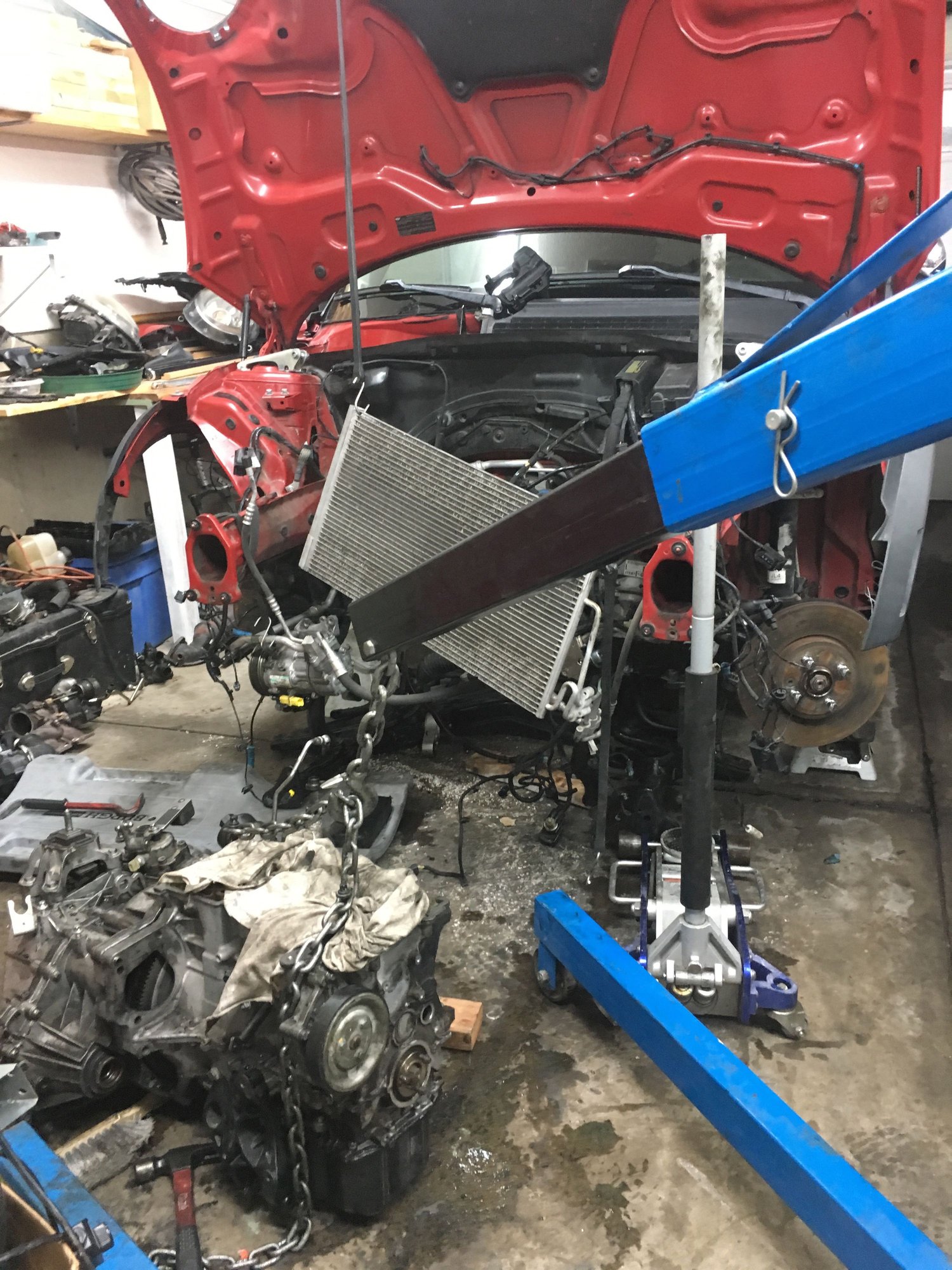

Last week I picked up two Mini Coopers. I guess because I'm bored and these are small and looked fun to tinker with.
Mini # 1 is a Chili Red 08 Cooper S with 88k miles. I paid 2200 delivered from a used car dealership that tried to repair it and gave up. It is reported to have a new clutch and pressure plate but jumped timing. I now believe they may have installed the pressure plate backwards. Still unsure. The timing guides were only partially there so they were due regardless.
Day 1 Mini #1
Day 2. Crank still tight. Head looks OK.
So I had been watching another add on Craigslist ....... 2007 Cooper S Similar circumstances, New clutch / flywheel @ 75k miles and at 82k miles and is reported to have timing chain or possible valve issues. Since I'm a glutton for punishment and .... why not..... I toe the second one home for $ 2000

I decided to dig into Red first. It had an odd story behind it. The dealer I purchased it from had put in a new clutch and then said the timing jumped. Employee who installed the clutch got fired. The motor was froze so I pulled the front end and head but the motor was still froze. Head looks good. I decided to drop the subframe and motor / tranny to get to the bottom of it. Everything went pretty well until I tried separating the motor from the tranny. I spent about an hour and a half , wrestling, trying to separate the motor from the tranny and it feels as if it is hooked somehow on the fingers of the clutch.
I have it about an inch and a half apart all the way around and it is not coming apart. I'll have to find some type of separation tool tomorrow because every pry bar I own would't get the job done.
On the up side, the motor is not froze and It was an improper clutch install all along. I ordered a head gasket kit and a timing chain set tonight. After I get the clutch sorted and everything cleaned up, parts should be here around the 20th and I can start reassembling. I'm keeping track of costs and it looks like this one should be under 2700 fully sorted. New front and rear seals, clutch, belt, timing chain set and all odds and ends. Good thing I work for free. I'll take my time putting it back together and make damn sure I get all the torques correct.
