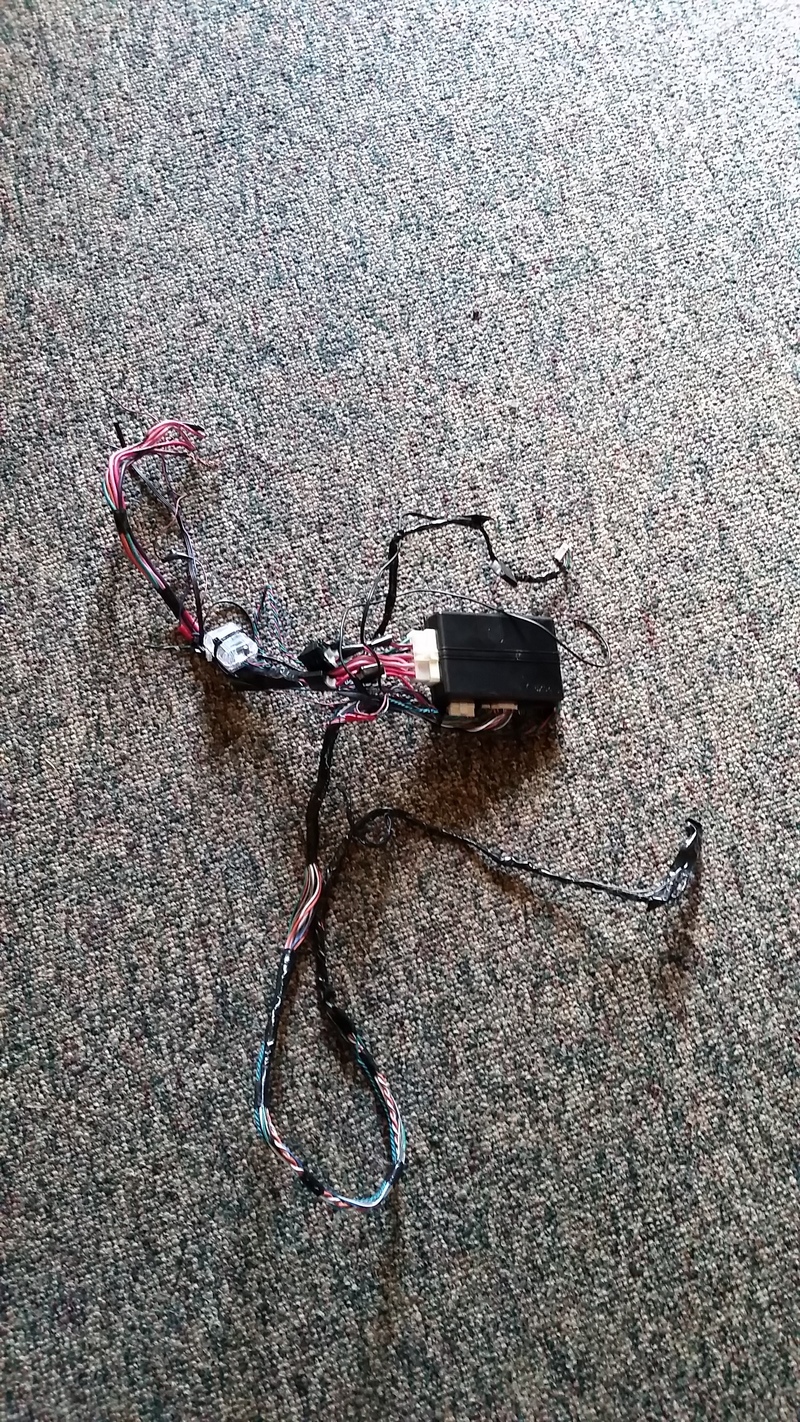

So my door locks were randomly unlocking themselves this morning. I figured from reading I had a wet bc1, upon popping some trim off to access it I found some wires half @$$ spliced together, just cut twisted and taped going into the plug that controls the locks and windows. Ended up spending my morning when I should have been asleep (I'm working overnight shift currently) re wiring my ignition and that one bc1 plug, and pulling this monster out. It was rooted into the car like a bad tumor.
Doing some research and google-ing I found out it is a remote start and keyless entry alarm system made by Viper. I did not receive the remote for it, so out it came. Boy was that fun. Fingers crossed locks seem to be fixed now.

OH no , someone tried to fix it before or something. :(
