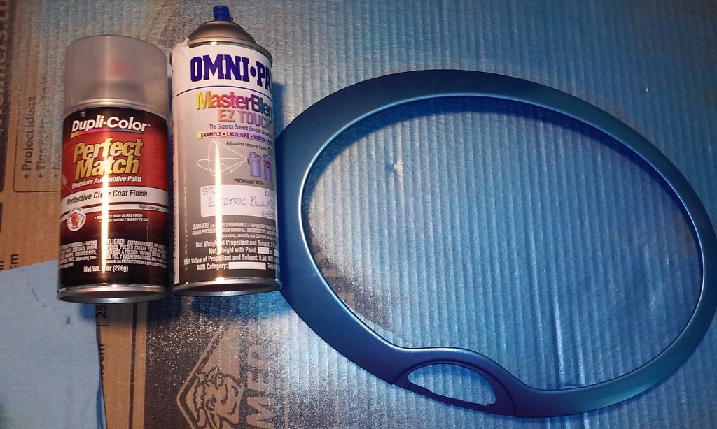

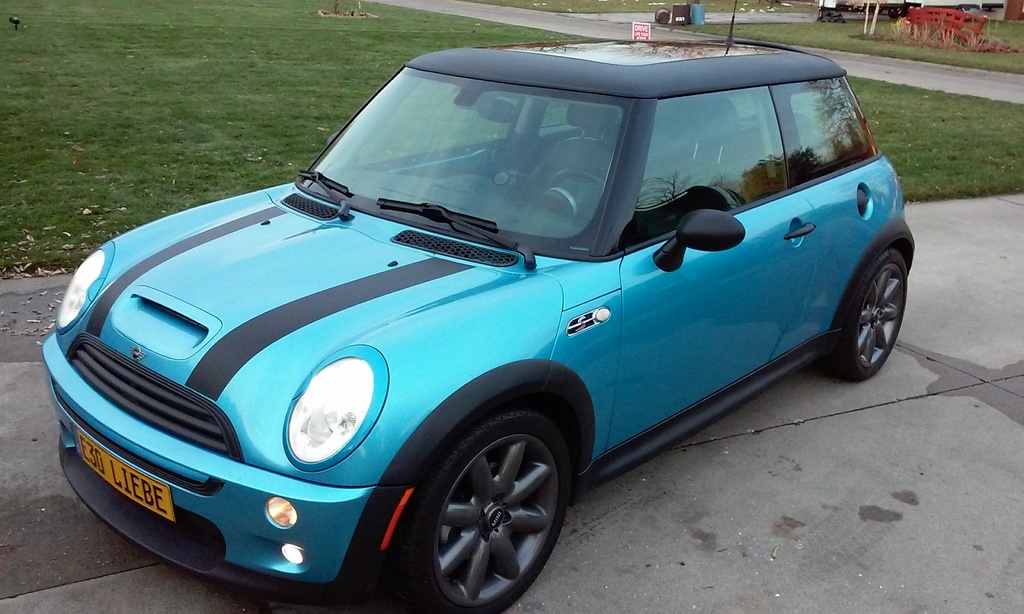

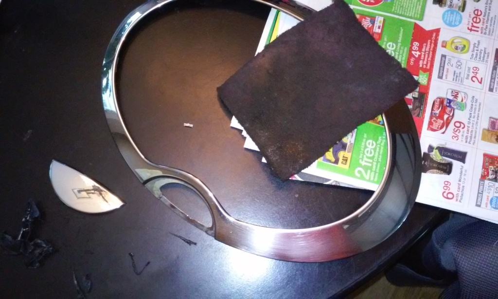

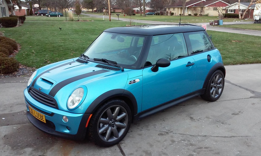

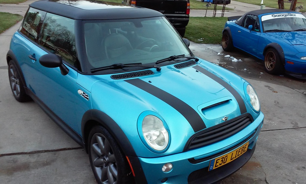

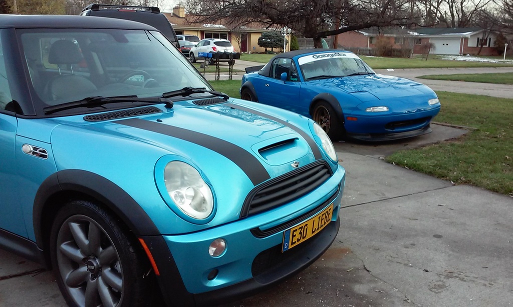

I took the advice of MiniRoadstah and paint matched the head light bezels. The black bezels made the front a bit busy.
scuffed the shiny chrome for adhesion

Self etching primer
Paint mixed at local auto parts store

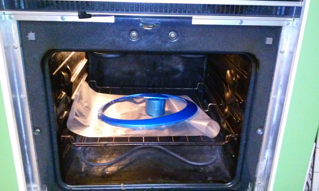

Please do not tell my wife about this part.......

Cleans up the front. You have a great looking Mini. Plus, a lot of painting talent.
Won't say a thing about the oven.

No true talent, the black is plasti-dip. Very hard to screw plasti-dip up. The wheels and bezels are simple rattle cans that anyone can do.

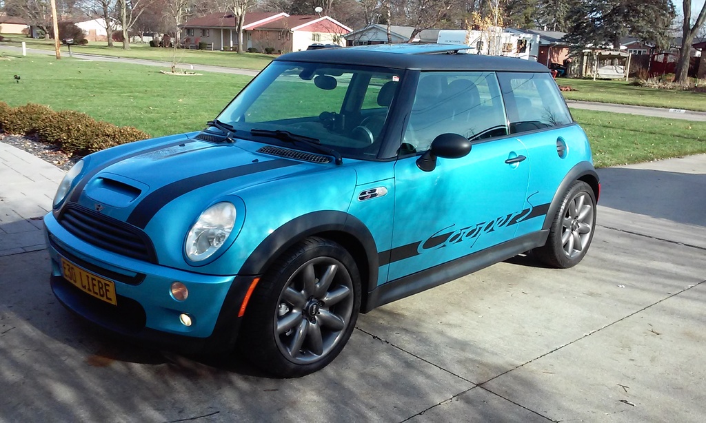

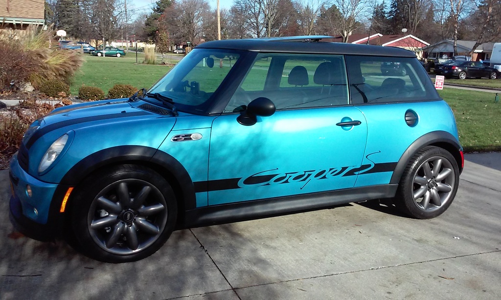

Carerra style decal

Continues to look great. Cooper side stripe script does look like the Porsche writing and looks good on a Mini. The Cooper S stripe looks better.
How's the interior?
Old Dec 1, 2015 | 11:49 AM
  #32
Posts: 36,758
Likes: 2,548
Yes, looks pretty close.

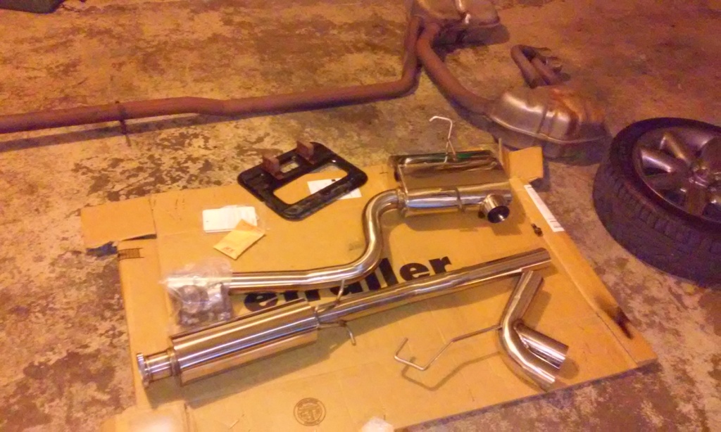

Out with the old and in with the new. Ireland Engineering cat back was a breeze installing, no issue what so ever. Took about an hour on my garage floor. All fasteners and hangers worked perfectly. The sound is smooth with zero resonance. Perfect tone and nice burps and gurgles. The price was $380, far less than the more popular ones.

That's tease. Let's see those new shiny exhausts on the Mini!

It's dark out now (darn day light saving time). One tip is slightly longer than the other, nothing a little trimming couldn't handle. I'm satisfied with the way it sets, it's very slight and only noticeable if pointed out. The tone gets deeper and deeper the more I drive, I'm in love. I'm very happy I didn't go with the more expensive ones, heck it's only piping and a muffler why should it cost an arm and leg?

No drone at all. I'm very impressed with the system. I've done tons of research and was about to pull the trigger on the miltek and decided against it. The single muffler is supper light and was very easy to install. It only has two main parts and then the tips. It goes together like butter. I kept waiting for the "hard" part but it never came. When I was done I kept thinking I missed something.
Shipping was fast and took only five days coming from CA to MI.

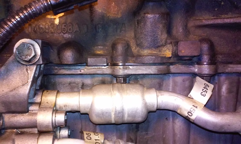

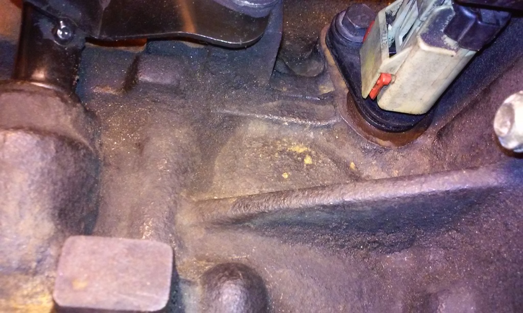

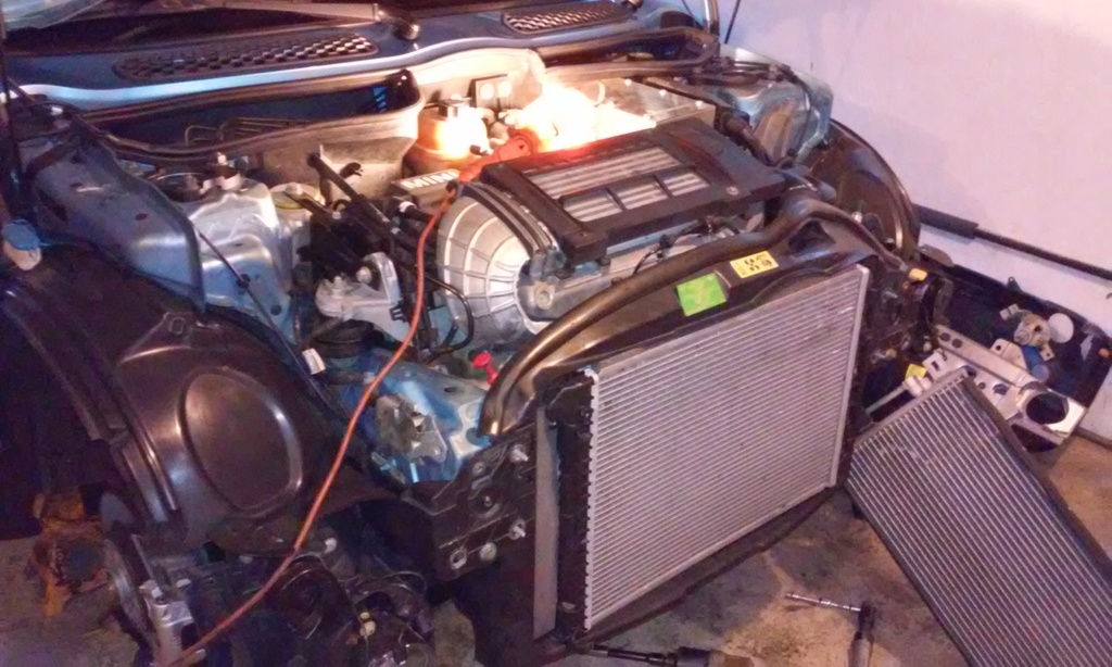

Started on the supercharger oil change and fill. Thanks to Mod mini on youtube for his great point of view videos. I was able to get this far in about an hour (air tools). My oil pan and crank sensor were bone dry but I'll be changing the O ring anyway. My gaskets and oil should be here in the next day or so. My confidence in working on and maintaining the mini has grown. The more I drive and tinker, the more I enjoy owning this little pup.
