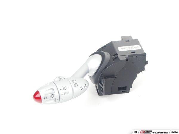

Hello and congrats on the new MINI Convertible, its a R52 code MINI.
Alarm Retrofit Kit 65730393977 R52 Convertible
http://www.ecstuning.com/Search/SiteSearch/65730393977/
Then :
Additional wiper stalk needed for status red light.
Prior to 1/2005 will take a different stalk then after 1/2005.
Then programming by MINI dealership.
What is your production month/ year ?
