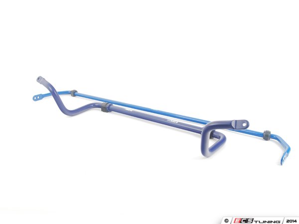

You can start with a H&R front and rear sway bar:
http://www.ecstuning.com/Mini-2012-Cooper-R56-S-Coupe-L4_1.6L_N18B16A/Suspension/Sway_Bar/
