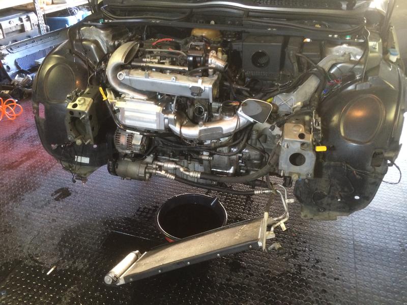

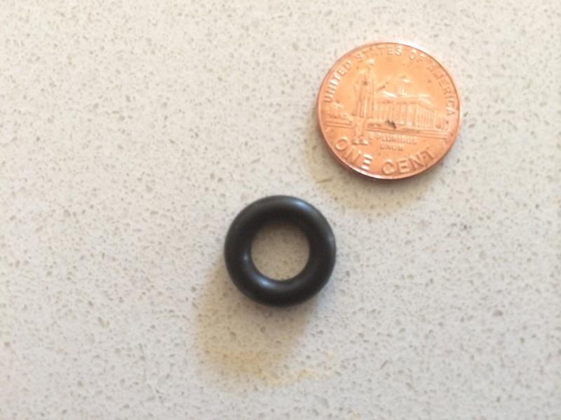

Tore the front off the car to replace three grommets ")
I'm trying to track down the P1477 code: "Reed valve cannot open"
On the OEM supercharger intake ducting, the connectors for the vacuum tubes are quick-release couplings which work pretty well, "nice tight fit"
The rubber grommets supplied with the sprintex are a little wimpy. They tighten around the vacuum tubing by way of a bracket that "crushes" the grommet around the tube.. when pulled down all the way, the tubing is still a little loose = vacuum leak..
After trying a few fixes, before i replace the vacuum diagnostic pump, I decided to go with "thicker" grommets.. hence my day of "pit stop" practice
I was driving the car by end of business… quite pleased with myself..
We'll see if i get the code in the next couple of days..

Well The belt and seal were a pretty easy repair, Flushed the charger with a couple of quarts of redline…
1k on the Sprintex!!
Figured out the P1477 code, rotten rubber seal on the small breather tube that "T's" into the vacuum tube under the big S/C horn. I'm ready to tune!!
But, it's gonna have to wait until I get the car back from the painters… having the rear hatch repainted… Plus, the paint job on the rear fender looks like orange peel.. Painted!!… Also, at the same time, i'm gonna have the interior console "Down tubes" painted the same color as the exterior color, should look nice..
