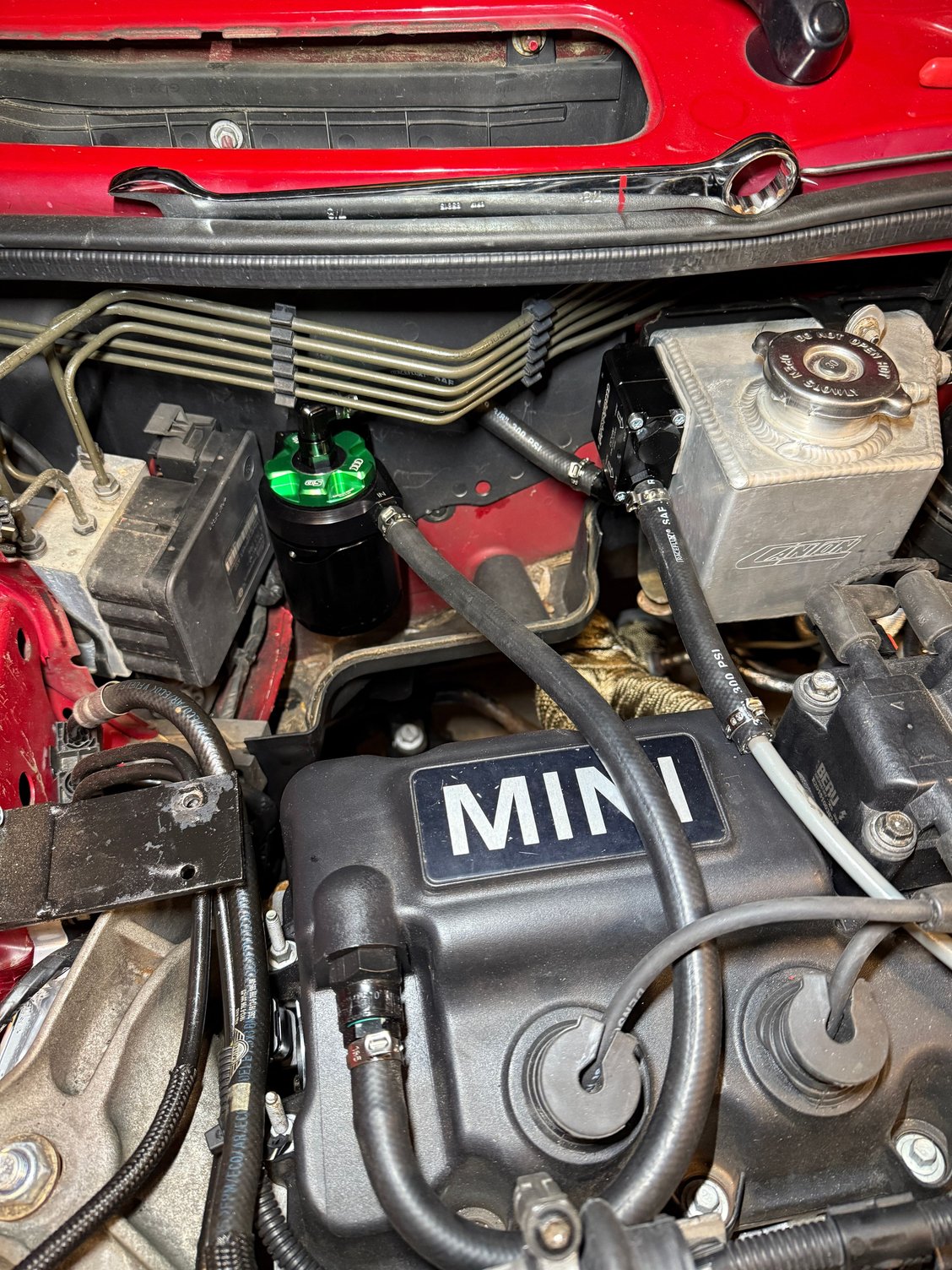

Been chatting with some very knowledgeable folks in the mini community about my car and the issues I saw on track. Car was pulling 7+ degrees of timing due to IAT correction and another 4 due to knock correction past 6k rpm. Car has a 7.5k limiter so the car was severely down on power most of the time on track plus the recovery period in the ecu after seeing excessive IATs.
Decided to do a standalone PCV setup using improved racing components. Their new CCS high efficiency catch cans are really free flowing and effective. Dual catch cans, remote check valve and two restrictor valves will be put in place of the stock PCV valve to prevent any oil from entering the intake tract and to ensure smooth idle with the restrictor valves while maintaining a free-flowing system. I'm assuming my new PCV has failed which is causing the excessive blow by. Best to just go to a more efficient and effective system.
Stock intercooler will be removed and coated with Cerakote thermal transfer and will add a diverter to help airflow to see how that affects the IATs. While apart, the entire intake tract will be deep cleaned as well as the header and exhaust to clear out all of the oil residue coating everything.
Lastly, I'll be swapping to a EWP and controller, Davies Craig 115 to relieve the SC and further reduce IATs and generally improve the system and free up the SC.
When everything is blown apart I'll see what else can be done to improve the IATs.
Once I address these issues, I'll log the car again to see how these have hopefully reduced the IATs drastically. Car will be back on track next season!

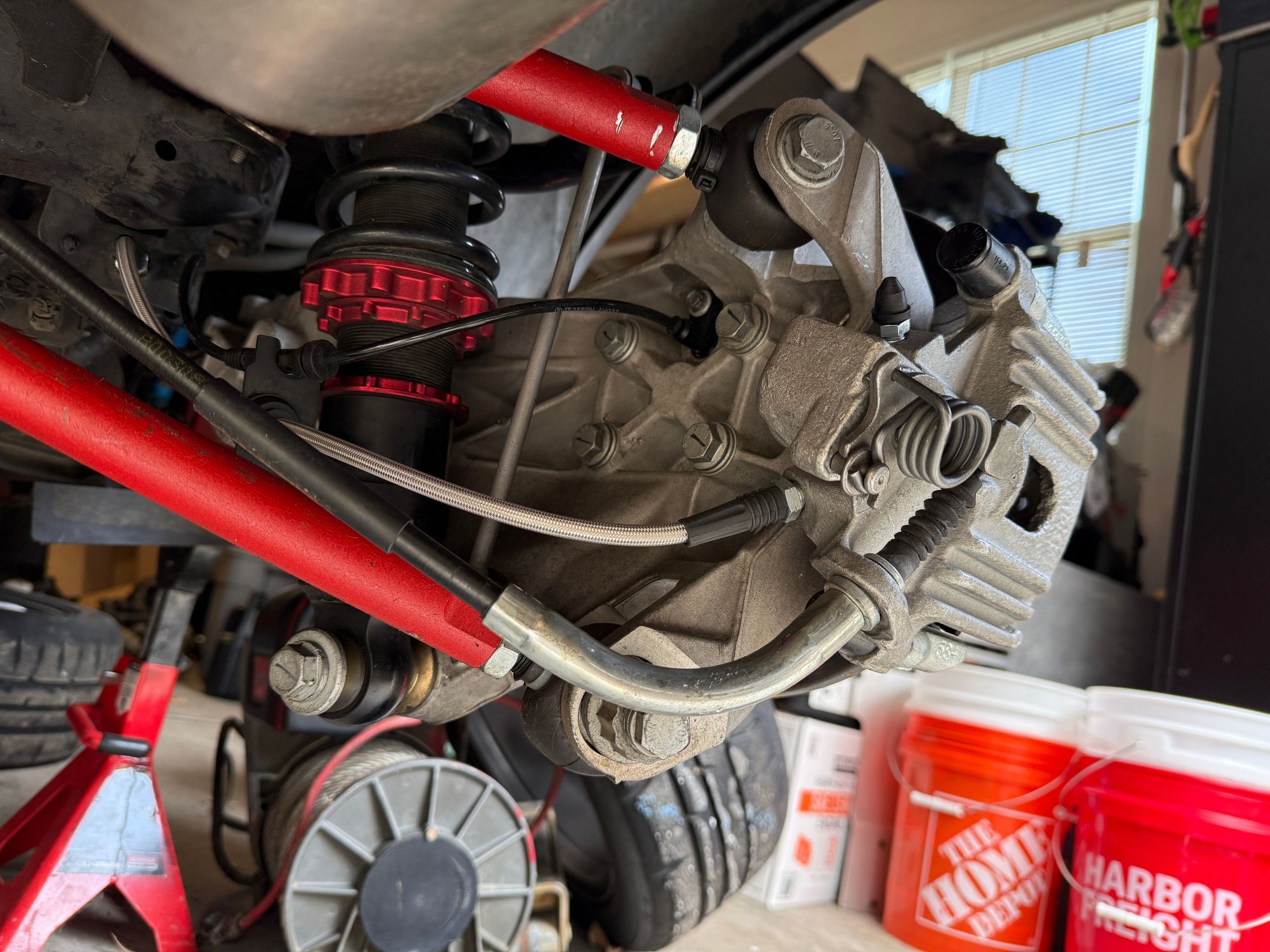

Few more notes and some pics.
Upon first start up after sitting, car ran for ~4-5 minutes while I was burping the cooling system and a horrific induction noise started and a clacking. After a moment of panic I started diagnosing and thinking it through. I narrowed it down to most likely be the SC given the induction noise and pulled it to confirm my suspicions. Sure enough, it had a ton of play in the rotors. Can't decide if it was coincidental that it failed after sitting for 6 months or if there was an underlying issue that finally was catastrophic. Also wondering if it may have caused some of my higher IATs like bad/seized bearings. I'll look into having it rebuilt since it's a ported M45 but need to do some research on vendors. Luckily, I pulled a low mile M45 out of a 2006 MCS parts car I bought a while ago and had it on the shelf. This one is nice and tight. Nice teflon coated M45 went back on the car and the noise was gone and all is well once more!
Other new things done.
1. New stainless brake lines
2. New rear calipers as one of my old ones was dragging
3. Finally welded in my Wideband bung to the x-force header instead of running it in the rear o2 port.

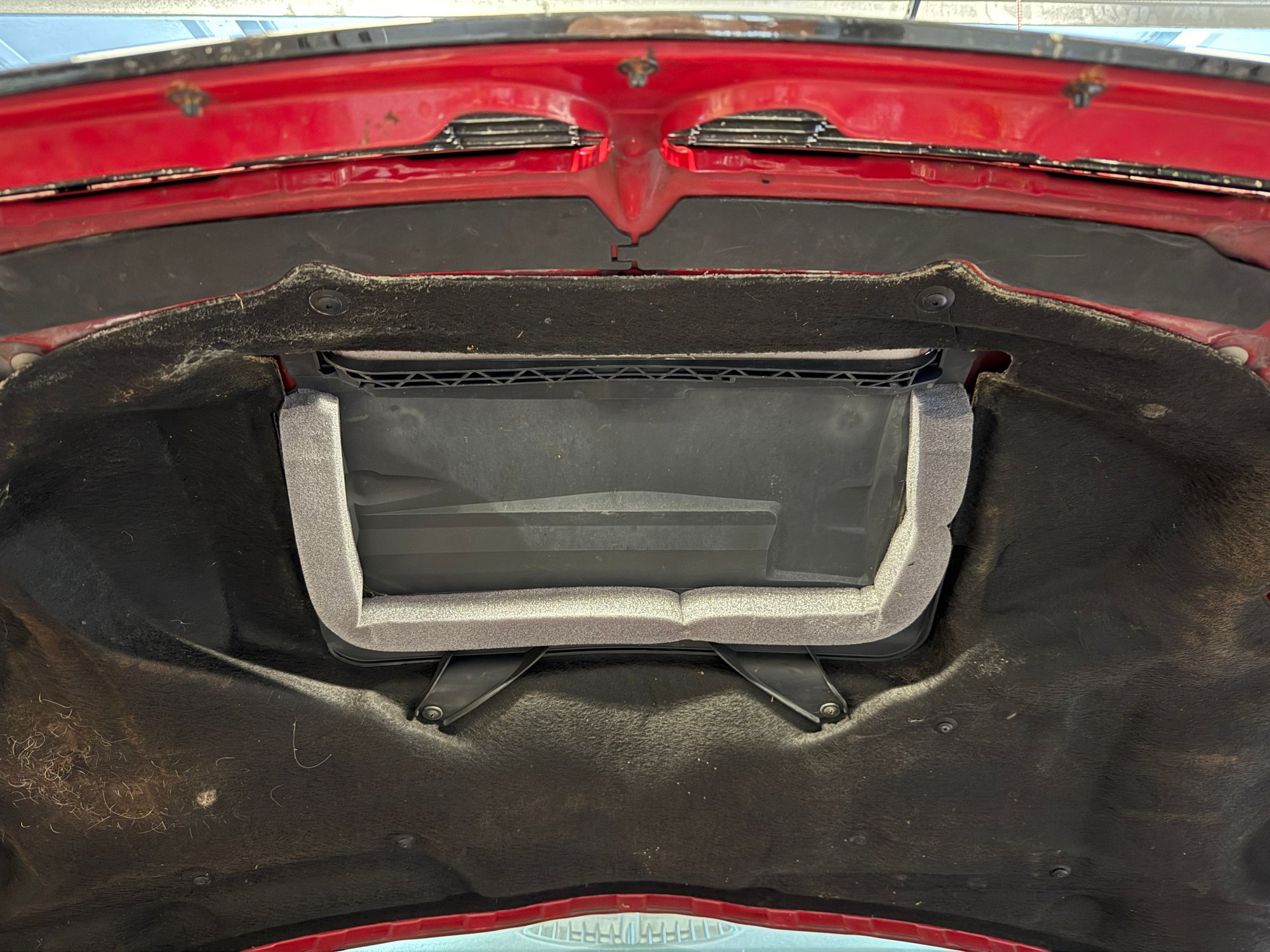

4. Added new foam to the hood to mate against the intercooler diverter as my old one was 1/2" gap. This should help direct air through the IC. Used some dense HVAC foam from Home Depot.
5. Put my spare M45 with teflon rotors on the car.

I've been battling calipers for the past couple of weeks. First one of my rear calipers I bought from RA had a stripped bleed screw, then one of the fronts came with the wrong bracket so pads wouldn't fit. Now, another front one is leaking air around the bleeder causing a soft pedal and fluid coming out around the bleeder while trying to bleed. I've bought maybe 20-24 calipers from RA over the years with zero issues and now suddenly it's like one after another is bad. Going to see if I can replace the bleed screw on this one instead of trying to get yet another new one. If that doesn't work, I'll buy new Napa calipers. Frustrating!

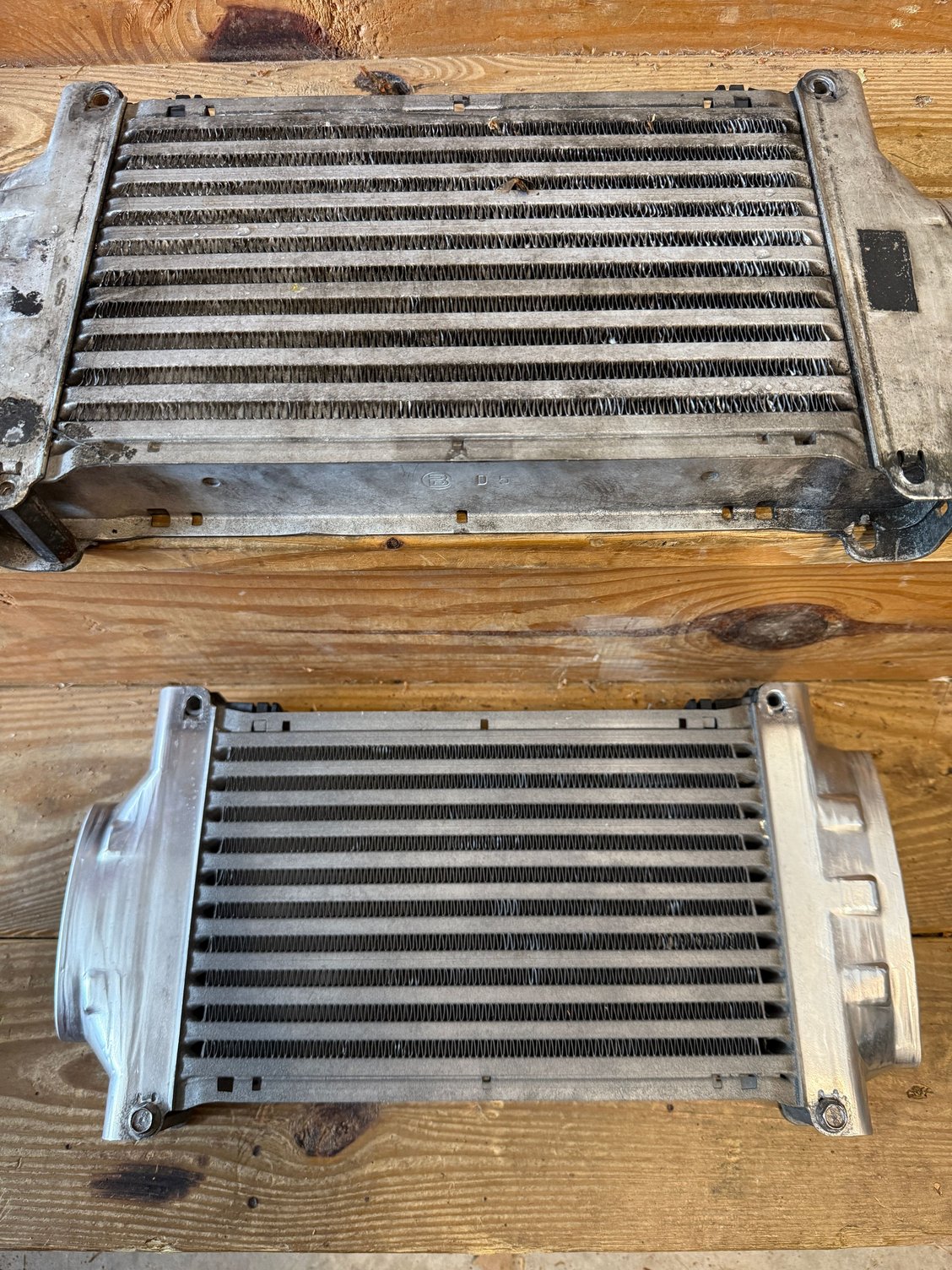

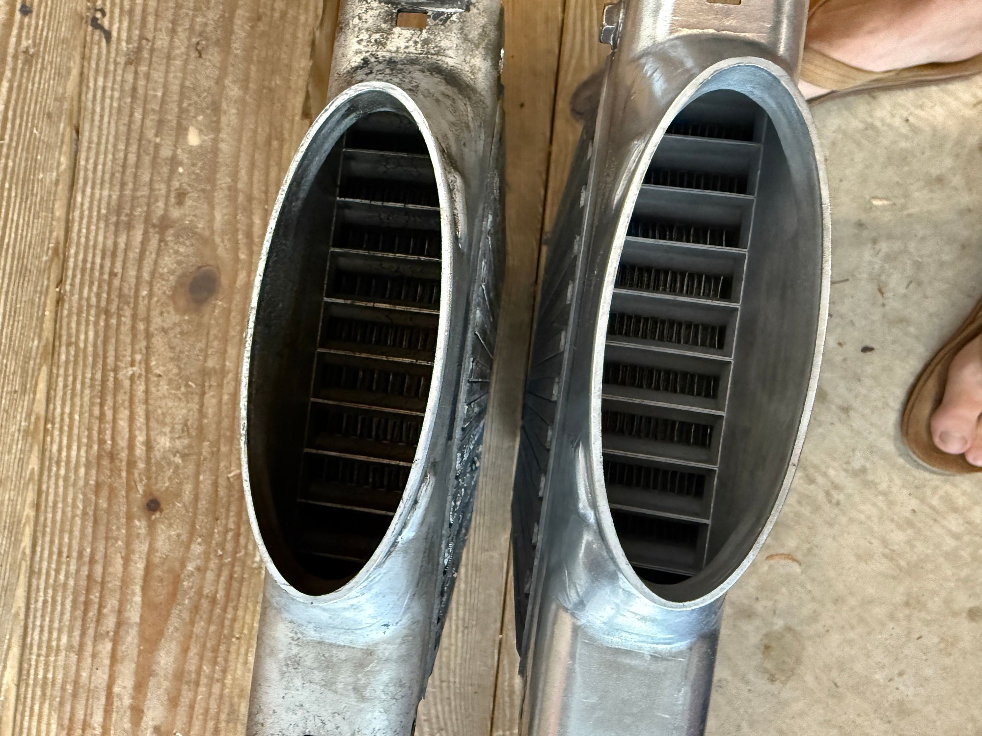

Newly coated intercooler on that was cleaned and coated with Cerakote heat dissipant coating. Also had a slight tune revision from Adrian since the AFRs were super rich up top in the rev range.
Other than that I've just been trying to put miles on it.
Old is on top, new is on bottom.

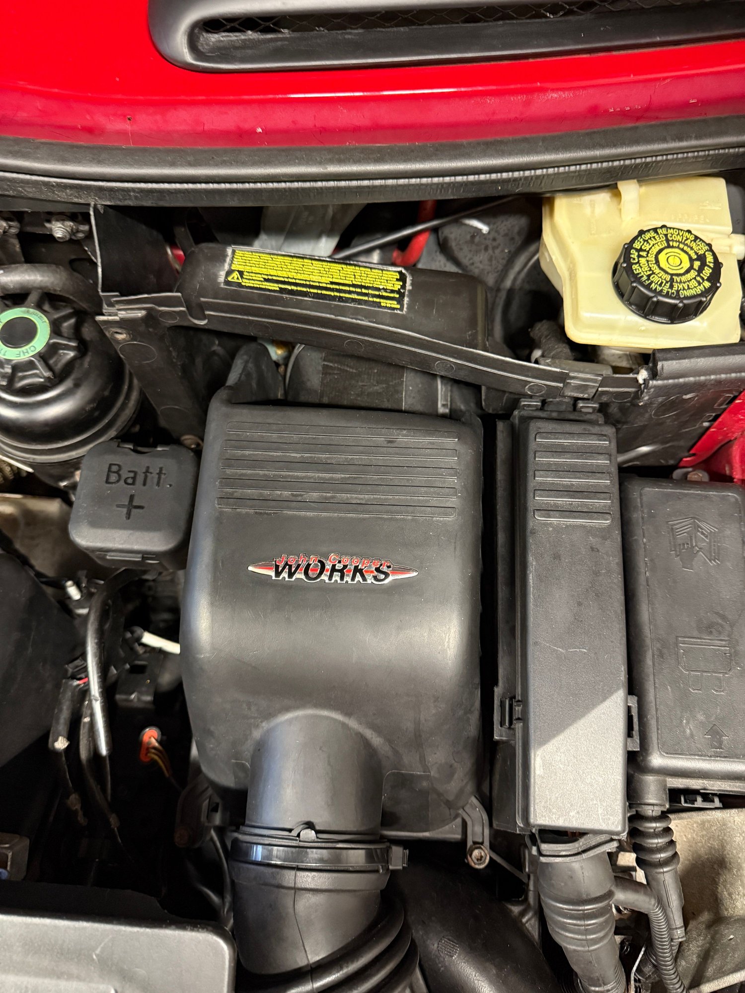

I also got my new intake cowl piece fitted with my existing JCW box and am in process of putting on some cowl scoops to feed more air into the box hopefully dropping my IATs. I'm beating around the bush of doing a BVH and water injection to keep IATs in check to see if I can get them in a reasonable range with some other, cheaper mods first. We shall see!

Took the car for a drive today with the intake cowl installed and ebrake removed. I must say, the car is definitely more spunky with the ebrake cables removed. I can now see that it was definitely dragging!
The intake temps are MUCH more consistent now with the cowl. I also added some intake scoops on the cowl. During acceleration, the temps still climb but a lot slower and they stay much more consistent around town whereas before they jumped all around depending if I was on throttle or off. I call this a win on both accounts!

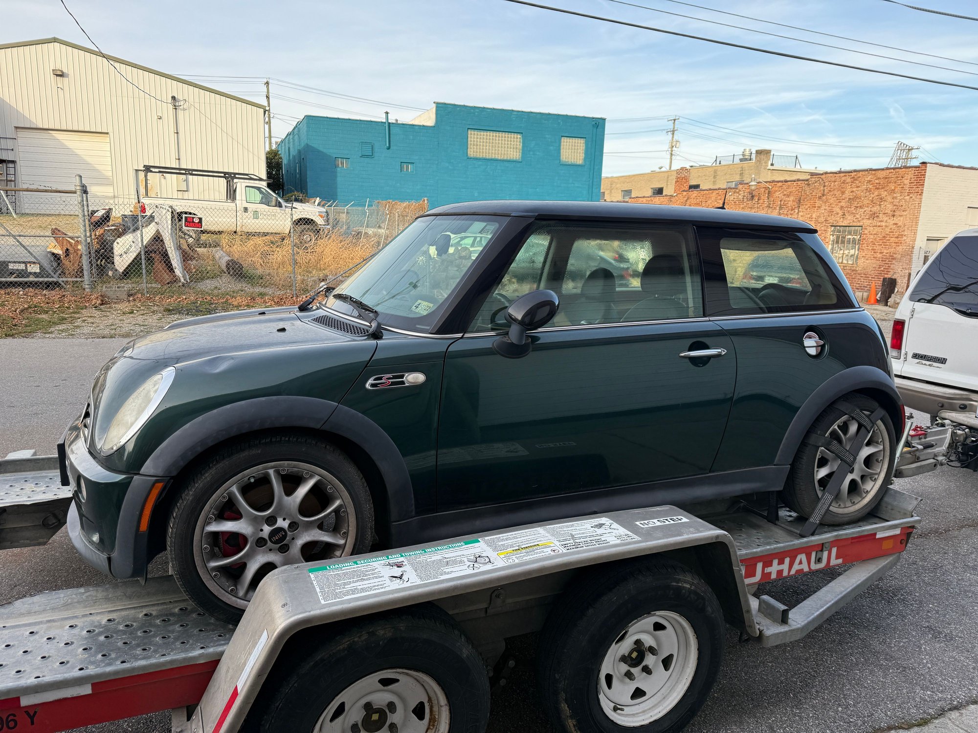

Well, right as I thought I may be getting out of the Mini game, I went to visit a buddy who owns a shop/towing company and we were chatting about my R53 and he mentioned he had one that he wants to get out of his lot. Long story short, I left with a free 2006 JCW 6MT in BRG/Cordoba with 113k miles. Besides the bad tint and fender dent in the hood, the car is in nice shape but needs a little mechanical love, nothing major. Interior looks mint. Hope to have it running and driving soon but knowing me, I'll have to resist tearing this one down for a full refresh. Pretty stoked except for the fact that my wife seems to have taken an interest in it...we'll have to see how that plays out.

That's awesome, nice find! JCWs without being modified are rare these days. This one looks all factory.
P s. We all know you're gonna do that refresh anyway 😄

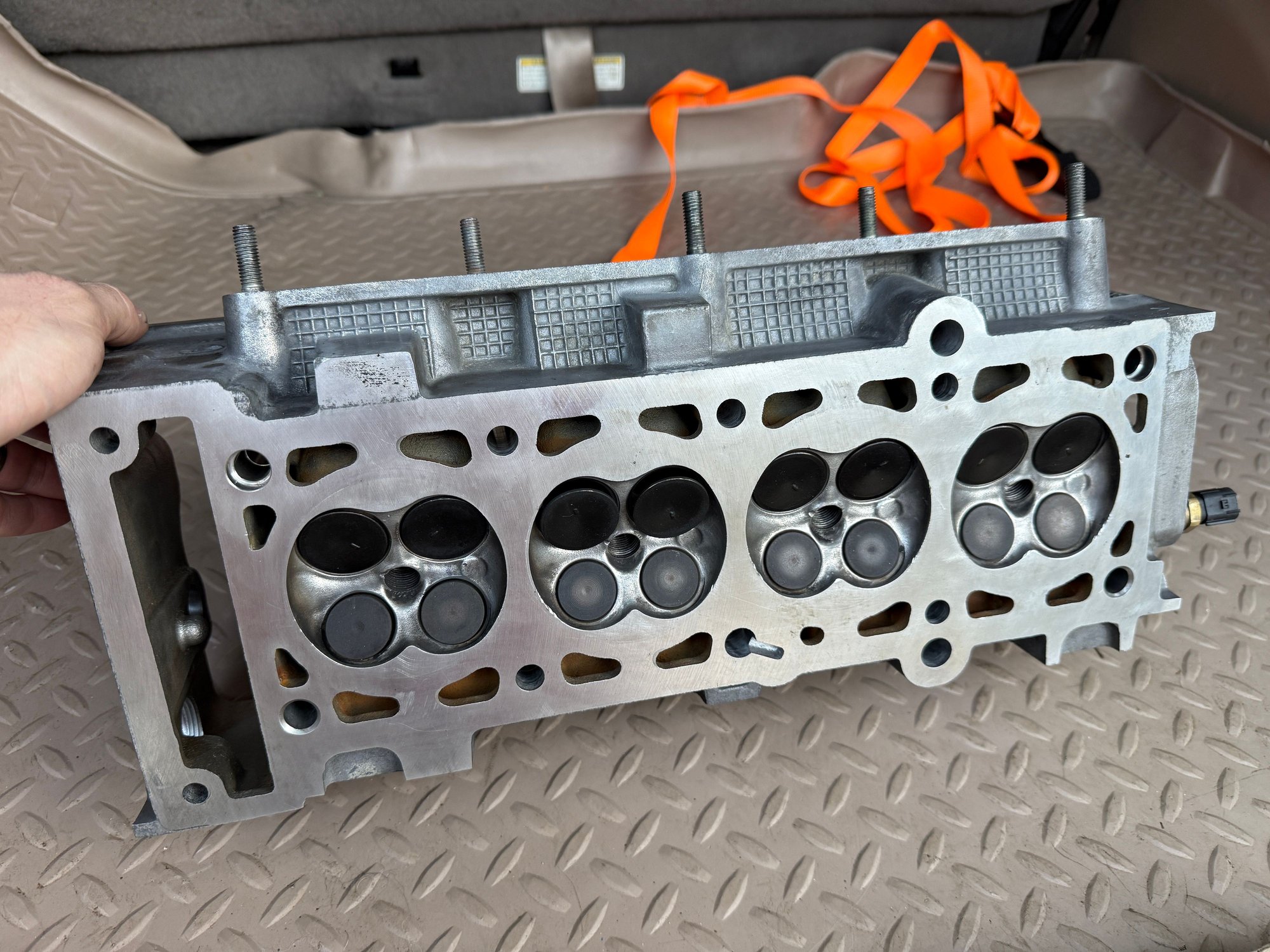

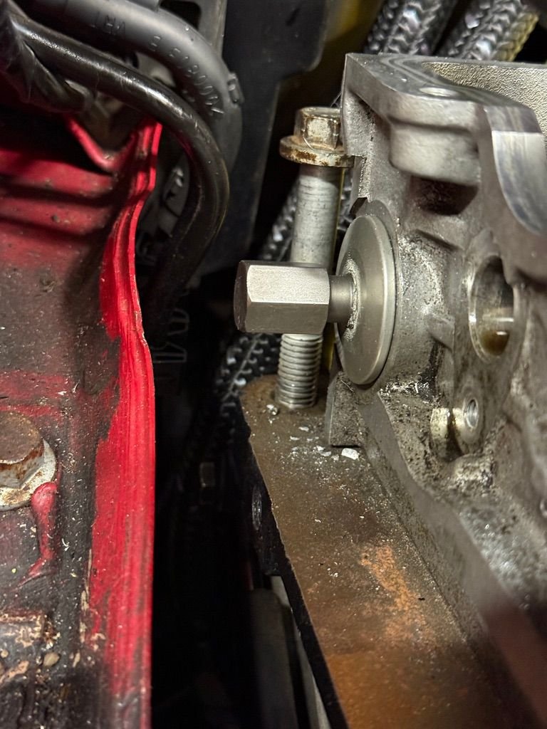

This was frustrating but I never ended up putting new guides in the head when I had the motor done as I couldn't find any at the time (supply issues from Covid) and so I rolled with the valve guides that were in the head already (likely stock). Well, for a while now, the car has had a puff of smoke at startup after sitting and slowly has been getting more and more oil smoke during operation until it turned into a misfire the other week when I went to start it up after a couple months of sitting. So I took the head off and sent it back out for new supertech valve guides and seals and valve/seat grind. Got the head back on and the engine mounts back mounted tonight and just need to finish assembling the engine and put it back together. This should fix my issue and bring the car back to 100%.
I'm also thinking of re-routing my oil cooler lines to be low instead of going up and over the engine. Will see what I come up with...
First annoyance was one of the heads of the timing guide bolt plug (?) stripped. Ordered another from FCP to replace it.
Head off and at the machine shop. Cometic head gasket looked great. Ordered another to go on as I don't re-use them.
Freshly serviced head!
