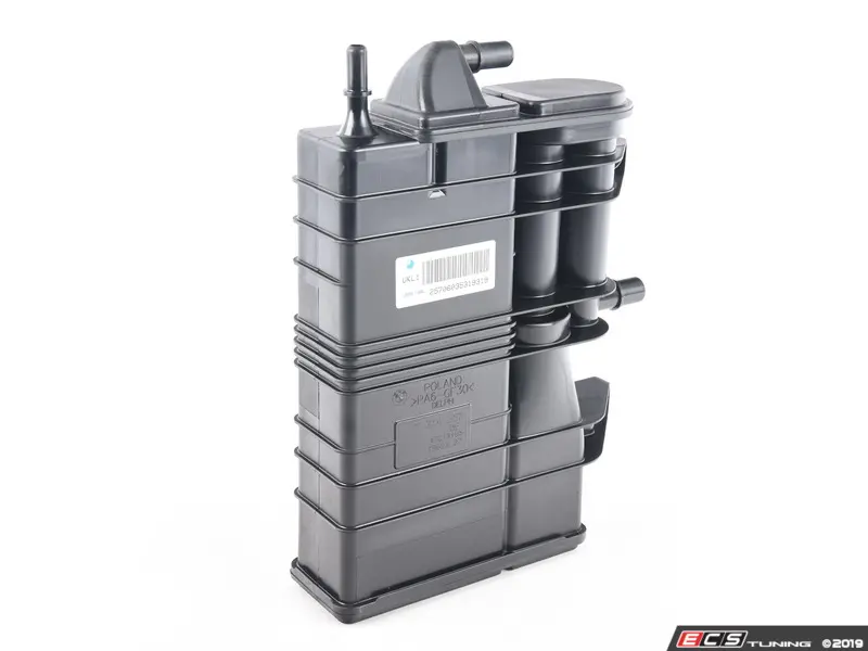

That goes to the charcoal filter my bet. Yet it does.

https://www.ecstuning.com/b-genuine-...117314257~oeb/
