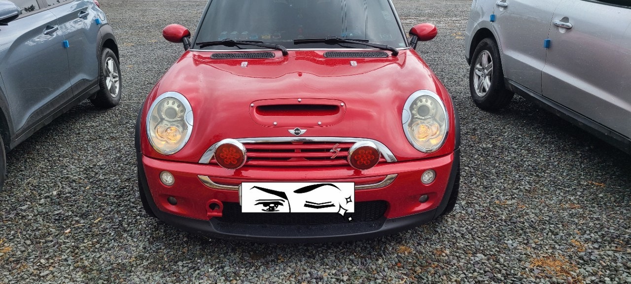

Completed the coding of the Mini Cooper R52S Convertible.
You can check the video through the link below.
1st generation R50, R52, R53 coding list
1.Plug in keyhole to open/close convertible top (check) R52
2. Plug in the keyhole to open/close windows and sunroof (check) R50 / R52 / R53 common
3. Open/close the convertible top by remote control (check) R52
4. Open/close windows and sunroof with remote control (check) R50 / R52 / R53 common
5. One-touch raising of the driver's and passenger's seat windows. (Confirmation) R50 / R52 / R53 common
(Some models do not work with the passenger seat window)
(I found the passenger's seat code, but it is not being added.
6. Even if the door is open, raise the window with one touch. R50 / R52 / R53 common
7. Emergency light turns on twice (checking code) R50 / R52 / R53 common
8. Disable seat belt warning (check) R50 / R52 / R53 common
9. Digital speedometer activation (some models do not work) R50 / R52 / R53 common
10. Weekly driving lamp activation (additional) (confirmation) R50 / R52 / R53 common
11.Auto light sensitivity improvement enabled (added) (confirmed) R50 / R52 / R53 common
12. Door chime deactivation R50 / R52 / R53 common
13. When the vehicle is turned off, it returns to the wiper start position (check) R50 / R52 / R53 common
(Some vehicles are not applicable)
14. Automatic door lock with a vehicle speed of 10 km or more (speed changeable) (Confirmation) R50 / R52 / R53 common
15. Door is locked 2 minutes after unlocking (confirmation) R50 / R52 / R53 common
16. Open the driver's door after 2 times of the remote control open button and open the window (additional) (confirmation) R50 / R52 / R53 common
17. Elimination of lighting errors (caused by aftermarket LED lighting, etc.) (check) R50 / R52 / R53 common
18. Change of various units (check some) R50 / R52 / R53 common
Looking for more
