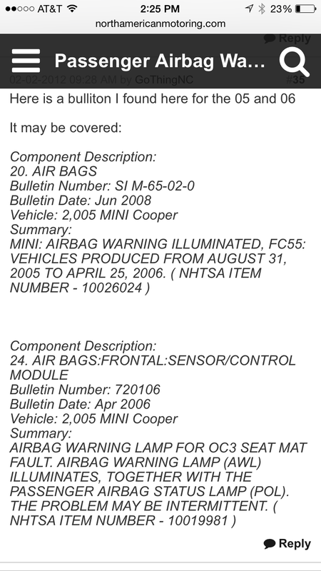

This is the bulletin I found:
I'm thinking of clearing the code because I don't want to be charged for them to fix or "diagnose" the code 88 that's being thrown by the B-pillar sensor.
Those are TSB's (Technical Service Bulletin), which are generally not covered beyond the standard warranty. Did you also find something about a warranty extension?

Alright, well, I spoke with Mini USA today regarding the seat sensor. I gave them the TSB code in question & their reply was - "While your car does fit in the specified date range, your VIN wasn't flagged as an affected vehicle, so the extended warranty does not apply to you." Damn it. Well, I got the C100 to clear the light today, I'm sure it's just a matter of time 'till it turns back on & I'll have to order the emulator on eBay. Boo.
